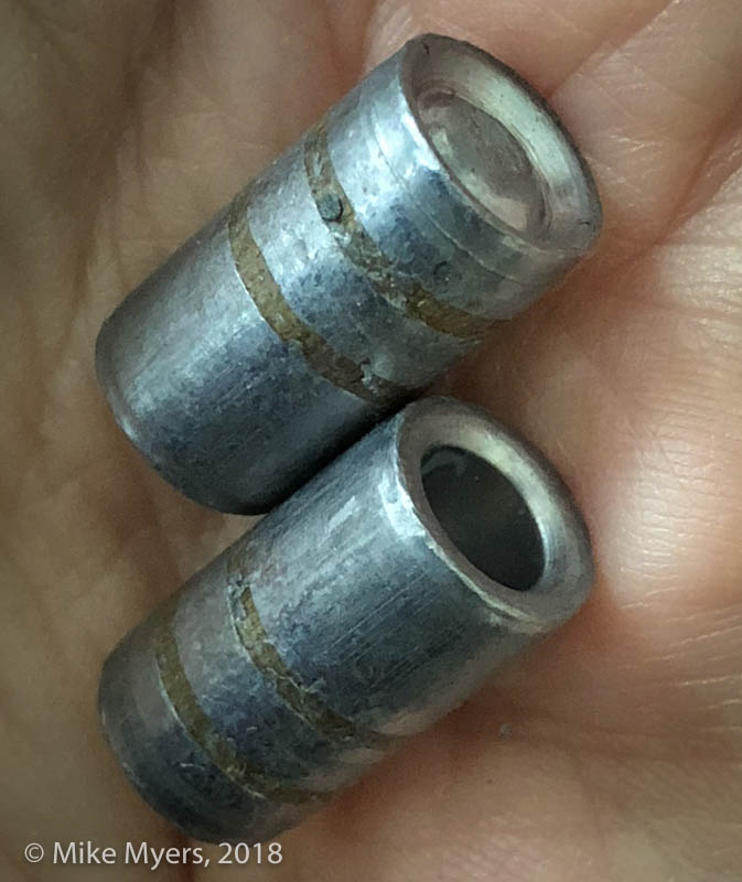

Post by mikemyers on Thu Jul 26, 2018 5:27 pm
Better photo.....

Post by mikemyers on Fri Jul 27, 2018 3:05 pm
zanemoseley wrote:I plan on using the Magnus 514 when I get my 1911/38 special. If you are having leading issues it may be related to the OD of the bullets. See if Terry has sizing options or even try the straight from the mold with no sizing at all.
When I first called Terry at Magnus, we had a long talk about bullets for my Model 52, and he discussed different sizes, which I didn't know anything about.  Terry then  said he'd ship me a box of what he thought would be appropriate.
Terry followed up by saying if these bullets didn't work properly, I should just keep them and he would send me another box of a different size.
By saying that, Terry gained me as a customer for life!  If I could buy the same bullets elsewhere for 20% less, I would still buy them from Terry.  .....this, and all the help he has been to me on the phone.
I posted a photo of the box Terry sent me up above - Len, are you shooting the same ones?
