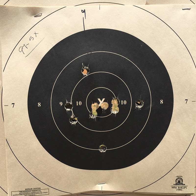

I found these two photos of targets I shot in 2700 matches (i.e. not practice).  The top one was shot using cast lead that was not weighed and sorted.  You can see there are five holes (after three slow fires) in the 6 ring at 6 o'clock.  After discussing with some HMs, we concluded this was due to varying bullet weights.  The next target was shot with swaged lead.

Sorry, but 6s are due to the loose nut on the trigger, not swaged vs. cast lead.

I agree with John, often we're too quick to look for reasons for poor scores outside of ourselves, its easier to blame equipment or ammo. I see your 6's were right next to pasters covering other shots. If weight deviation was the problem you would have likely had shots above the target as well not just below it.

Post by joy2shoot on 8/13/2018, 8:03 am
zanemoseley wrote:... I see your 6's were right next to pasters covering other shots....
Hence my reference to five holes.
The reason we concluded bullet weight is because in each case my POA and POI were right on from a windage perspective but not elevation.
What I called for those five shots => two 9 o'clocks in the 10 ring, two in the X, and one 3 o'clock in the 9 ring
What happened => two 9 o'clocks in the 6 ring, two in the 6 ring, and one 3 o'clock in the 6 ring
All the other shots you see, POA = POI.
And my POA not = POI has been reduced since switching to swaged.
And yes, I agree that the person pulling the trigger has more effect than ammo, which is why I drill/train/practice as often as I can and I work at calling my shots so that I can properly diagnose issues.

Post by zanemoseley on 8/13/2018, 11:08 am
Not trying to be argumentative but put that same load in a ransom rest, bet it won't be 1/10 of the vertical stringing you have in the picture.
