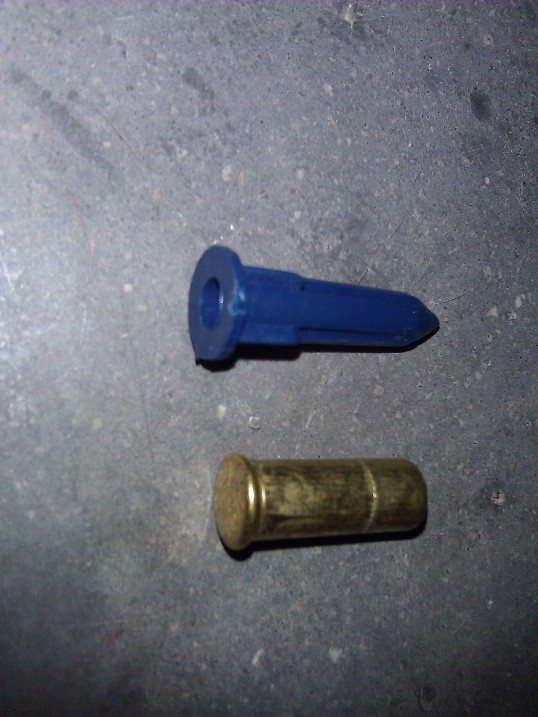

Post by Rob Kovach on Fri Apr 26, 2013 3:21 pm
Wingshot,
For dryfiring on a .22 use one of those plastic wall anchors in the chamber. It cushions the firing pin, they are cheap, and they are better for your gun than just dry firing. Just like Al said, you can dry fire, but you could damage your firing pin or your breech face. I say use the wall anchors, and feel free to dry fire with nothing for dryfiring during the prep time.

Post by Wingshot on Fri Apr 26, 2013 3:28 pm
Thanks, I happen to have some of those anchors!
