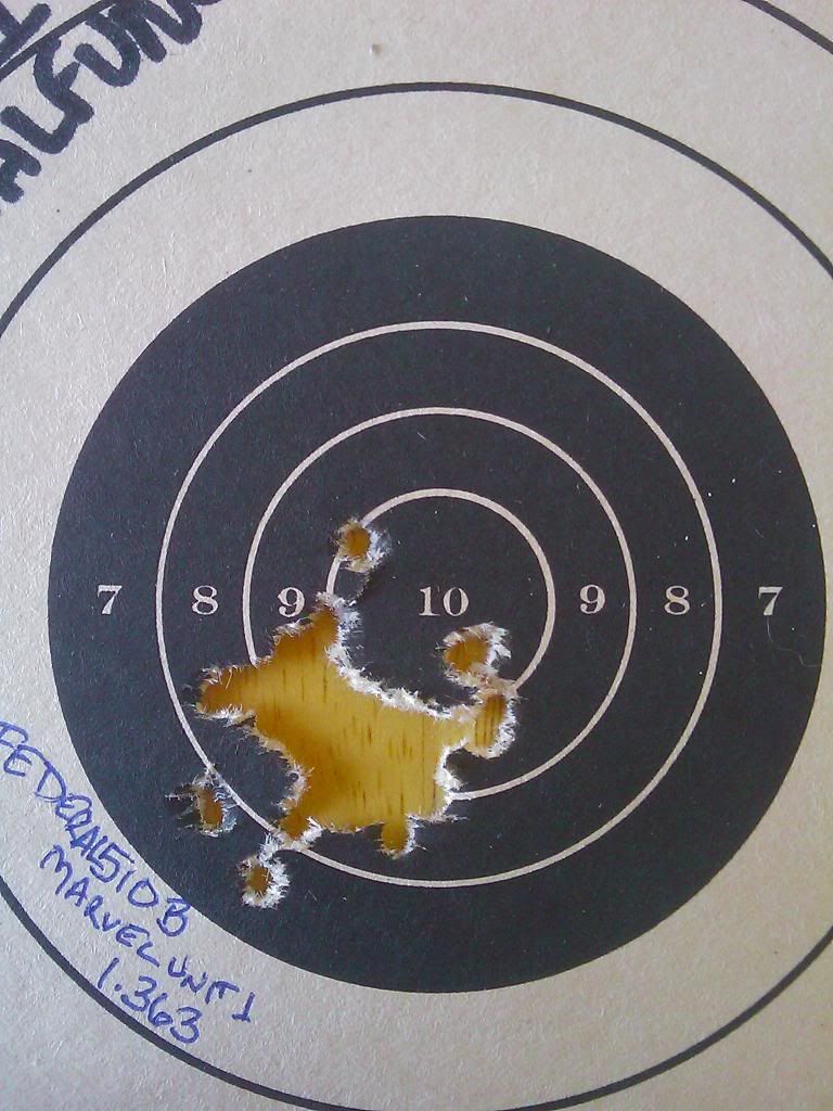

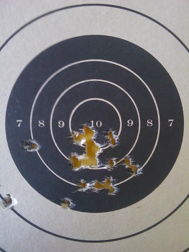

Post by Rob Kovach on 4/21/2013, 9:00 pm
I did a sand bag test with 25 rounds of Federal and CCI. Federal first, then CCI
