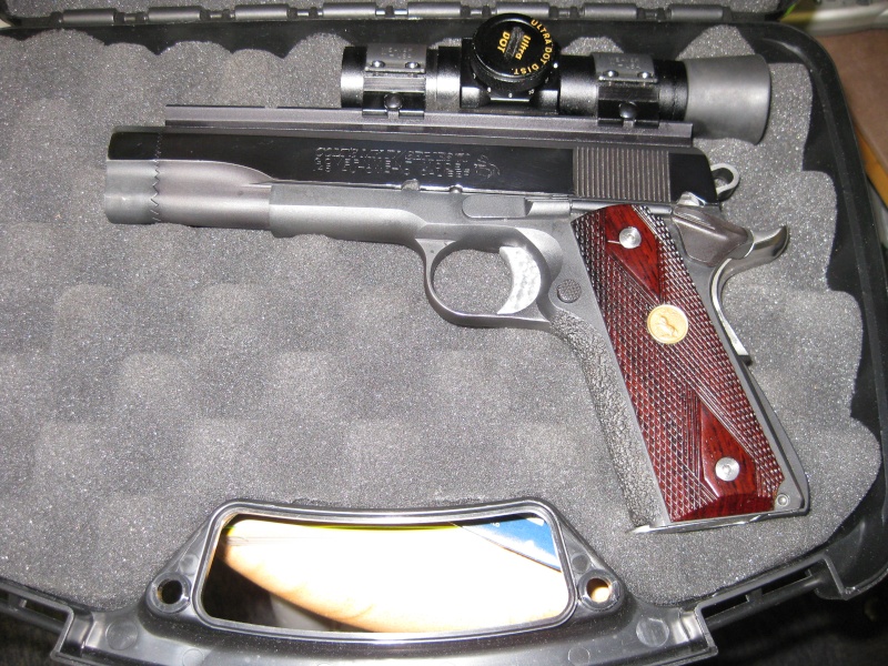

Post by DavidR 8/16/2013, 11:07 am
This one is the supreme model hand built by Travis Strahan  Accuracy tested by Herschel Anderson and only shot for one season. Comes with two tuned stainless mags and a extra  fitted short trigger. 4550.00, that's about 1100.00 under the cost for a new one.
Test targets for this gun were under 1.5'' @ 50 yards with factory Atlanta Arms 185 FMJ.
