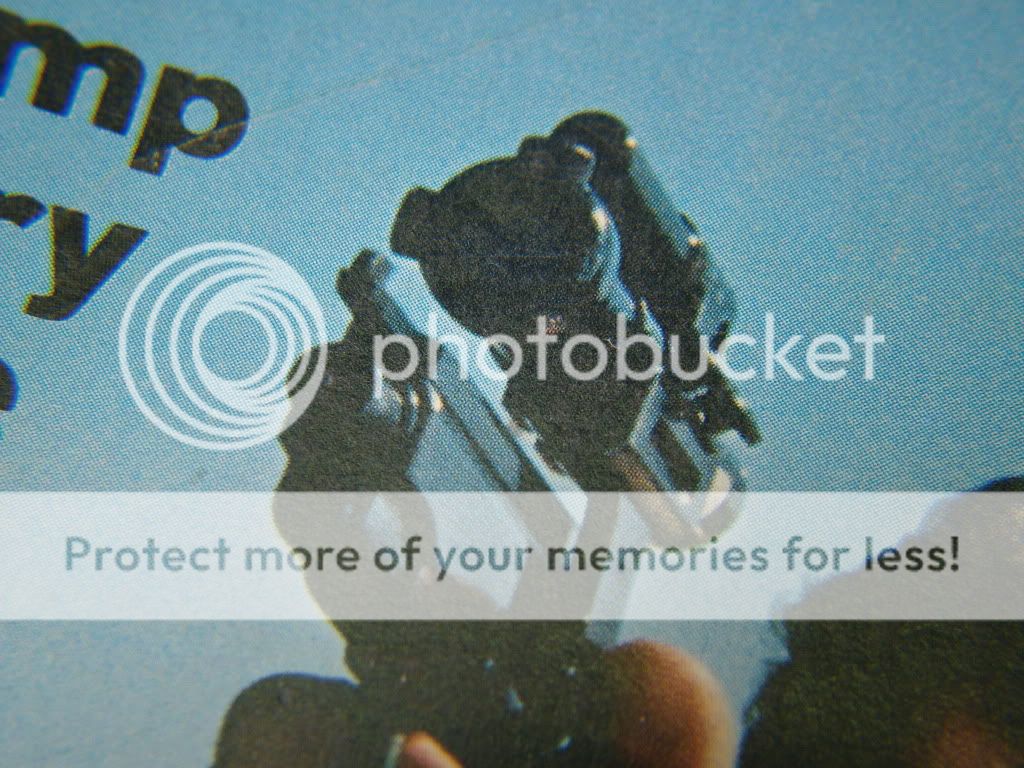

The early dot grip/mount...about 35 years ago..this shooter shot at the same club I belonged to in New Castle, Pa.
New Range Officer Owner - Need to Mount a Dot 003-3

Post by john bickar Wed Jan 15, 2014 7:03 pm
Jerry Keefer wrote:The early dot grip/mount...about 35 years ago..this shooter shot at the same club I belonged to in New Castle, Pa.
Is that Joe Pascarella?

Post by Jerry Keefer Thu Jan 16, 2014 12:12 am
Hello John;
Yes, that is Joe on the cover of American Rifleman 1980.. Oxford sight.. I had several of those.. Wish I had kept them for keep sakes/conversation pieces.. Joe was very very good.. and I believe the first to win Perry with a dot sight..
Jerry

Post by john bickar Thu Jan 16, 2014 2:14 am
Jerry Keefer wrote:
Hello John;
Jerry
IIRC Joe was the first to win with a dot, Lenardson was the last to win with irons. A revolution in the span of 15 years or so.
I never met Joe but he was from my neck of the woods; I also shot at New Castle and throughout NE Ohio/Western PA.
