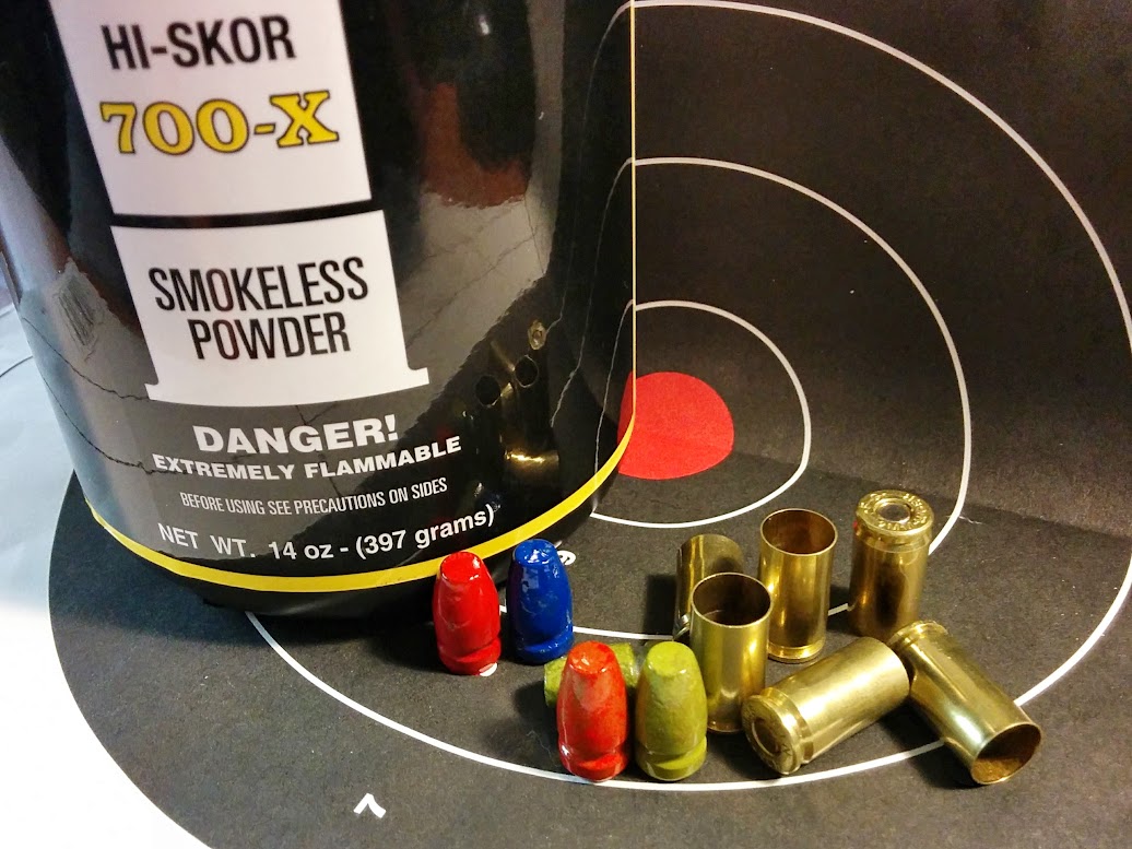

Saw some pistol powders (!THREE TYPES!) for the first time in maybe a month the other day, and in these days of buy what's THERE first and hope for the day when you can again choose your favorite, I went for the 700-X instead of the 800-X because I'm trying to keep my ability to assemble lighter loads for BE.
I guess the diameter of the charge holes on the Little Dandy powder rotors 5 through 8 are just too small for those big flakes???
Weights and even VOLUMES were all over the map. The drum is clean, nothing sticking in the hole, nothing to bridge or catch the powder as it falls, and running 3 or 4 charges into a .357 case (the #8 was uncomfortably close to overflowing at 4...) would be 3/16-inch below the case mouth on one series, even with the top for others, and mounded up in a nice 1/8-inch dome on a couple.
Weights were no better. One started at 3.5 grains then averaged 2.5 grains for one 10-charge series.
Will test the Star and Dillon slide type charge bars next. We'll see.

Anyone know of good .38 and .45 loads using this stuff? Does it happen to be tolerant of charge weight/volume variations in the amounts used in BE loads?

Oh, by the way, I have maybe 6 ounces of ORIGINAL Hi-Skor, and that stuff is small granules that look like coarse flat gray-green sand. Also fluffy (was old in 8-oz cans the same size as 1-pounders). That stuff throws quite consistently from the smallest Lil' Dandy rotor I have.

From what I remember of 700-X from my trap shooting days it had some yellow flakes in it. Just like how red dot has some red flakes. Does it still have them? I don't know the loads but I believe way back when 700-X was a very popular powder. I don't know about pistol but in the shotgun weights between red dot and 700-X were either the same or very near the same for the same load. I don't know the difference in burn rate between the 2 but I couldn't shoot 700-x because it would give me a headache. Tried it several times and always the same result.

I am using 700x for the long line of my indoor matches right now to try it out. Using 4.4 grains under a Zero 185 JHP. It does have some yellow flakes in it. Tried it because that was what Travis Frerking tested it with. It does not meter as well but the perceived recoil feels softer. When it gets warmer out side I will shoot a few outdoor matches with Bullseye compare the scores and test them both from sandbags. Out my last four slow fire matches with it my average has been 185 which is normal for me right now.

Yup, it has yellow dots all right. At first I thought someone at the plant had sneezed some plastic grinding debris or something into it. Guess "Yellow Dot" is not only the wrong brand, but would sound too chicken for the shooting community??? Anyway, until reading your posts I was believing that IMR or whoever had decided to put taggants in it, for all the good that would do tracking terrorists and criminals who use either BP or genuine high explosives instead of propellants.
My Dad might have used this stuff waybackwhen--the size, shape and color of the flakes is very familiar, right down to what they look like when 4-8 of them stack up together and you get that shadow effect between them.
My belief right now is that the powder is bridging on the way INTO the charge hole in the rotors. The larger diameter rotor I have threw much more consistent charges, within the normal variations, and without the volume variations as well.

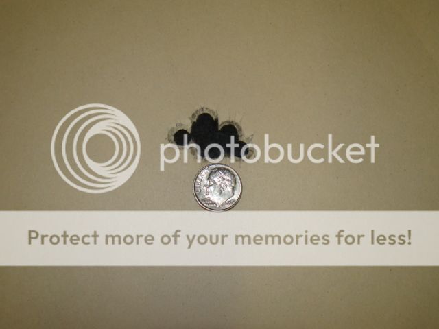

700X is a very popular powder and is used by some of the major ammo makers in match ammo.
The best barrel tester group I ever got was 4.8 gr. of 700X and the Zero Match 185 JHP..
15 shots...was going to try for 20 but chickened out..

WOW!
That group would be just fine at 25, but if it's at 50 it's outstanding!!! 15 shots no less.
When ya gonna test it again? That might be your "reference load" to make sure the gun hasn't shot loose.
Anyway, I think the biggest charge bar throws 3.88 (average of 10) of 700-X, and the accuracy testing with H&G 68s was under 3 inches, twice. I'm chicken too, but with a limit of 5 rounds per group.
