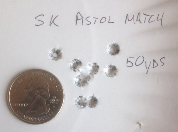

Hi, I just purchased a Nelson conversion. Received it a few days ago and just got home from doing some ransom rest testing. SK Pistol match, SK standard plus, CCI SV all grouped 1" or less for 10 round groups at 50 yards. Federal auto match grouped around 1.5" I got several 5 shot groups around .5"
 SO FAR, Im very impressed with the Nelson/ Marvel conversion. the machine work is top quality and it shot very consistently. I ordered direct from Nelson. Spoke with Larry the owner, for quite a while, really nice guy. I got the version with sights but will be ordering the scope base top for it soon.
