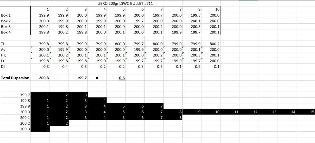

They were not as consistent as Zero or Magnus when I took random samples, and the lube made a mess in the Georgia heat.
The Zero/Magnus precision in weight is amazing.  I have another 2,000 so I'll add some more to the running tab, but as you can see pretty impressive.
