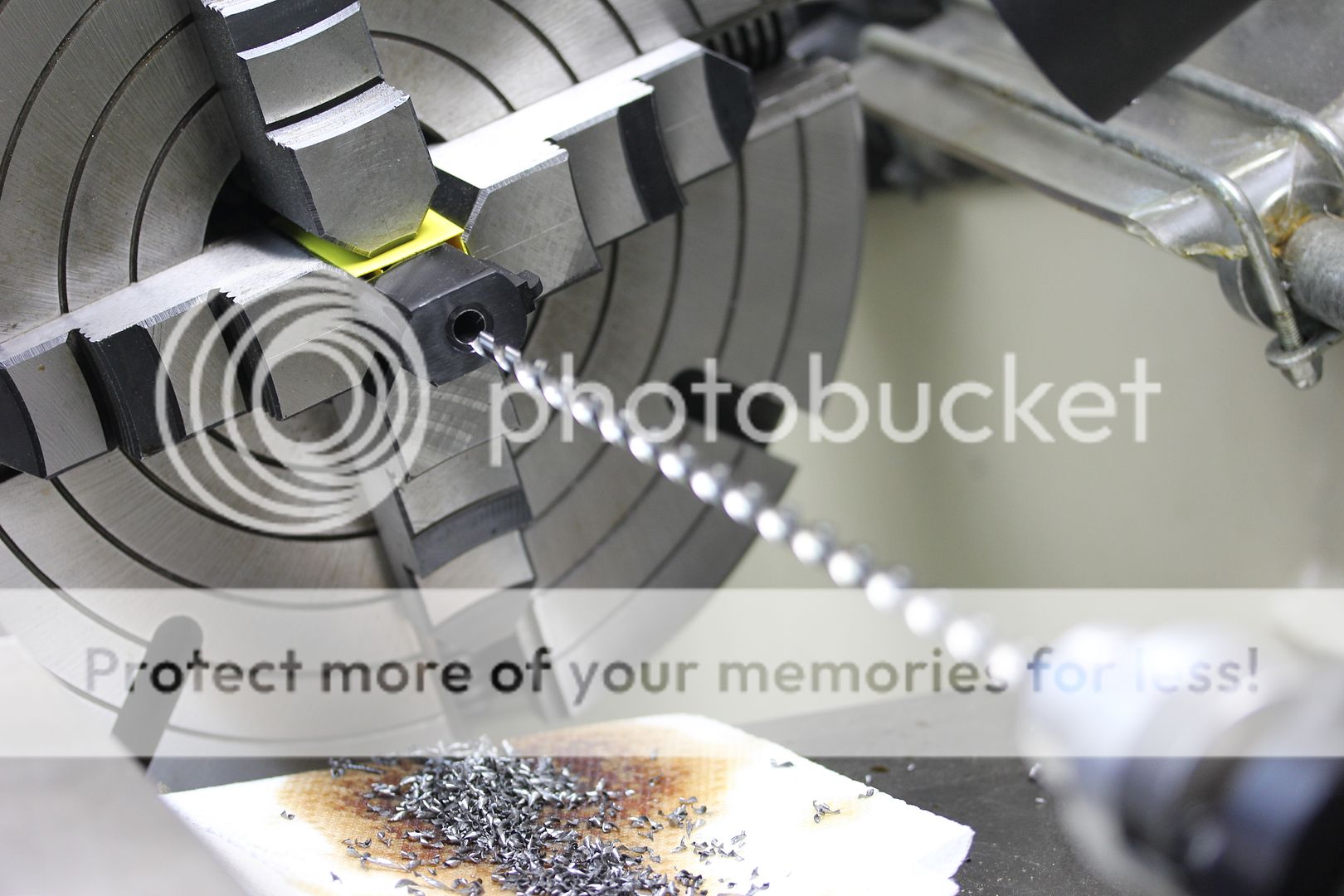

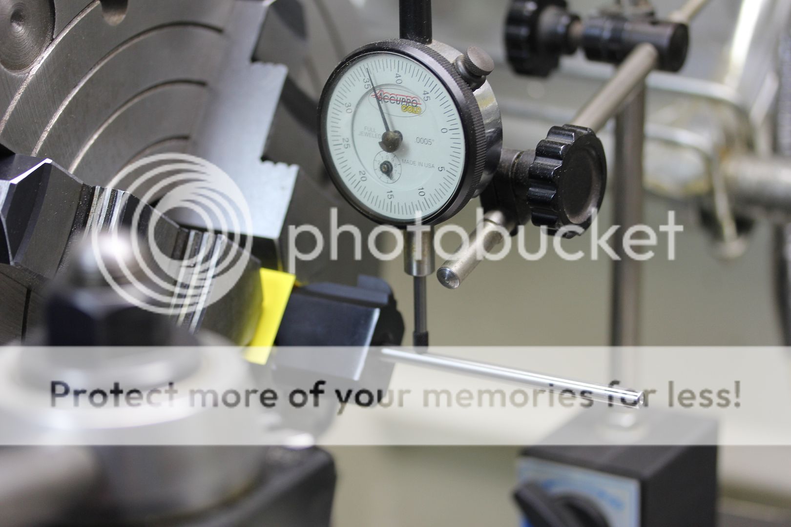

Post by Jerry Keefer on Sat May 09, 2015 7:42 pm
Jerry Keefer wrote:In regard to 22 pistols.. You've heard me say that the potential of a 41 is high...
I have a friend who recently put up an 890 with a 5.5 heavy barrel..  Hmmmmmm:)Smile
Here's one that is being prepped for transplant surgery...
