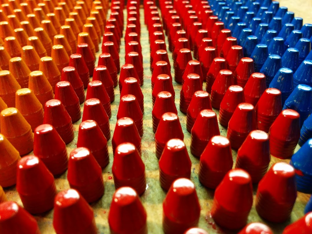

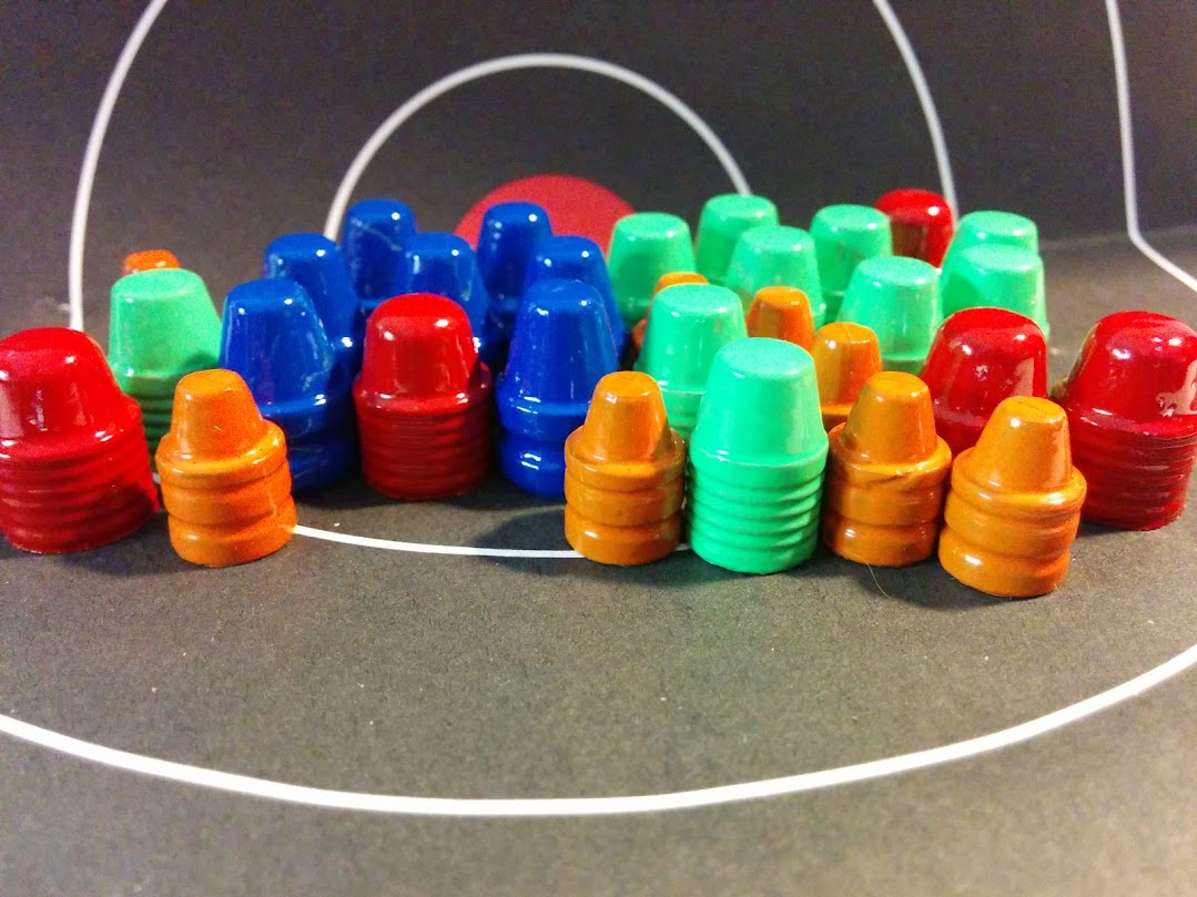

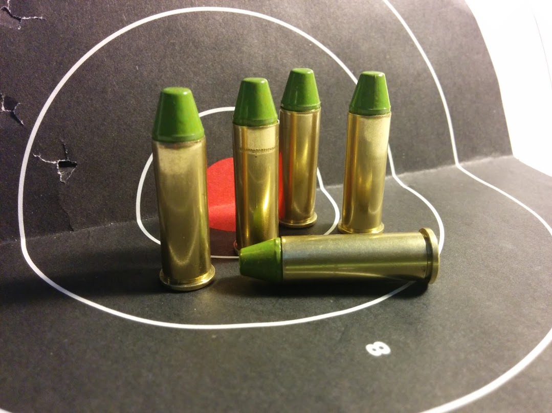

Post by guncheese on 9/7/2014, 9:46 pm
Colt711 wrote: colors to code bullets
actually thats a major reason
since the color palette is more or less unlimited
it has become a very good way to keep things labled
and it should be obvious to anyone else as well
like this
or
and yes they were! bright, orange and snappy!
