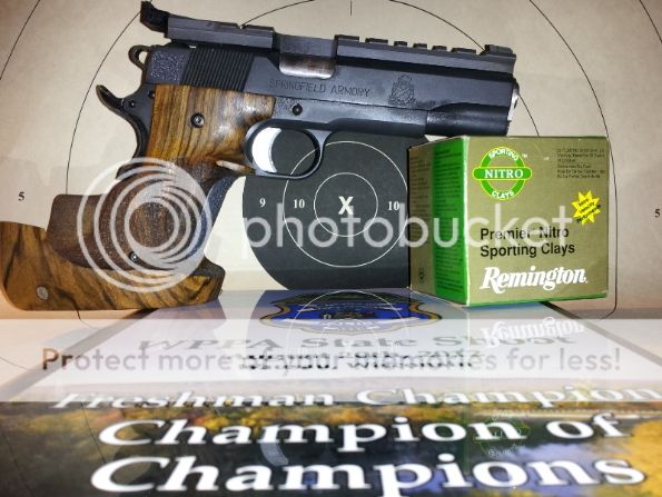

I have the same Rock River Arms mount on my Range Officer.  The back screw does go down into where the sight cut is.  I don't think the screw does much since it isn't clamping up a tight joint, but that is how my gunsmith installed it.  I like the rear ears to rack the slide.  Here is a picture...

Re: Slide mount on a Range Officer
Post by iawolfeman on 10/22/2014, 3:45 pm
That is exactly what I am doing.  Is the back screw actually in the sight cut?  Or is it only partially in the cut?

Post by dstates on 10/23/2014, 9:15 pm
iawolfeman,
Here is a picture of it where you can see the screw in the sight cut.
