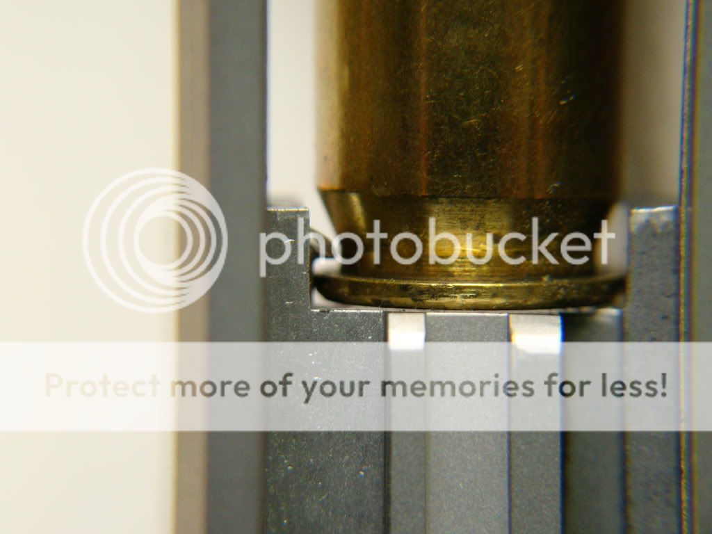

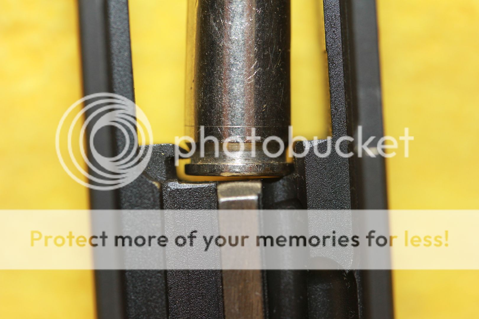

First step to setting headspace.. WHAT IS THE CHAMBER DEPTH...????? Then, all chamber designs are not the same, unless, a standard SAAMI reamer is used.. which is designed for the masses of the world...Not BE target shooting..What is the leade..SAAMI standard 5 degree.?? Let's use a 1-1/2 or 1 -1/4 degree leade angle which is proven in every venue of the target world to be beneficial regardless of the caliber..Would a BE chamber benefit from some freebore ?? Absolutely... and how about those sloppy chamber dimensions..??? Minimum wall taper.. The smokin hot guns that are approaching 1 inch groups at 50...have well designed chambers...
The first extractor is adjusted correctly. The hook touches neither the rebate angle nor the groove, and is pulled back to permit the case to seat flat against the breechface when in battery. Very little tension can be run, when so adjusted.
The bottom picture is typical of the industry standard, and has a negative effect on both reliability and accuracy..

Re: 45acp case length
Hi Jerry,
I think you just showed a picture supporting my 1st statement about the bullet seating on the extractor for industry standard 45s. The second picture shows the extractor hitting the bullet and holding it above the bolt face. If the bullet was actually in a barrel it wouldn't be cocked over but would be held in that position. In a perfect world the bullet would go into battery and just stop when it made contact with the case rim or stop against the bolt face as it pushes the bullet forward. In this world Newton says that is not going to happen. When the case hits it bounces back, when it hits the bolt it bounces forward. It rattles back and forth (whatever clearance you have) and settles somewhere between the extractor and the bolt face. Even if the extractor is not making contact with the case it is extremely unlikely (unless your shooting straight up or down) that the bullet would come to rest in contact with the bolt or the case rim. Newton evens things back out when the bullet is fired. The first thing that happens when the bullet is hit by the hammer is it is driven forward by the force of contact. The second thing that happens is the case (it is lighter than the bullet) is driven back against the bolt face until contact and then the bullet is propelled forward. The whole process happens fast but basically all cases are in contact with the bolt before the bullet goes forward. I know you knew all of that I am just letting you know why I think they headspace where I said.

LenOldMaster64 wrote:Hi Jerry,
If the chamber is cut to allow only .003/.005 clearance with the case against the breechspace, and case mouth against the chamber edge or somewhere in between, that is the static headspace. It is measurable and repeatable to within the .003/.005 range irrespective of the bullet. Frankly I like a little less. You're referring to dynamic headspace, and yes, most 45s have a considerable amount.. But that is not conducive to accuracy. On a minimum spec chamber, the case will seize to the chamber wall very quickly as the ignition process takes place.. Newton is there, but one thing I will argue, is nothing takes place instantly. All things are measurable.. It takes very little pressure for the case to grab the chamber wall. So exactly when the case head contacts the breechface in a dynamic headspace situation, is subjective.. Even for Newton..
The extractor pictures show how the extractor should interface with the case rim. The rim only is making contact with the extractor body.. Not the hook, and with only a few ounces of tension, it is not shoving the back of the case against the opposite side of the chamber. If, the chamber is minimum SAAMI in diameter and taper, it's not possible for the extractor to push it very far anyway. BUT we all know that not every chamber mouth is not minimum..
In the second photo, when the case is forced against the breechface, where does the extractor go..?? It's jammed against the rebate angle, and can even, depending on how precise the barrel is fit, force the rear of the barrel over..
In the first photo, the case is already in that position as it is fed into the chamber... and stays there during ignition. The .003/.005 clearence is negligible.

Jerry,
Hi again. I agree with everything you just said. My wad gun was built by Toyota and I assure you I don't have an extractor that is not working perfectly. I was referring to the 190,000,000 (WAG) 1911's that were not made perfect or brought up to perfect specs. Now I have to go see what the extractor on my RO looks like. Hmm
jerry, my extractor looks like the top picture and I measured my chamber to be .898 from the end of barrel hood and there is .005 between end of hood and bolt face that would make .903 the longest case possible I also measured from bolt face to extractor hook and that measure .081 so with all the rim thickness measuring .040 to .043 if .903 less .043 = .860 the shortest case could be and not hit the hook of extractor, none of my cases are that short but measured about two hundred today and they very .865 to .892.
I did order some starline brass today. to make long line loads. I also think the longer case should be more consistent group.
