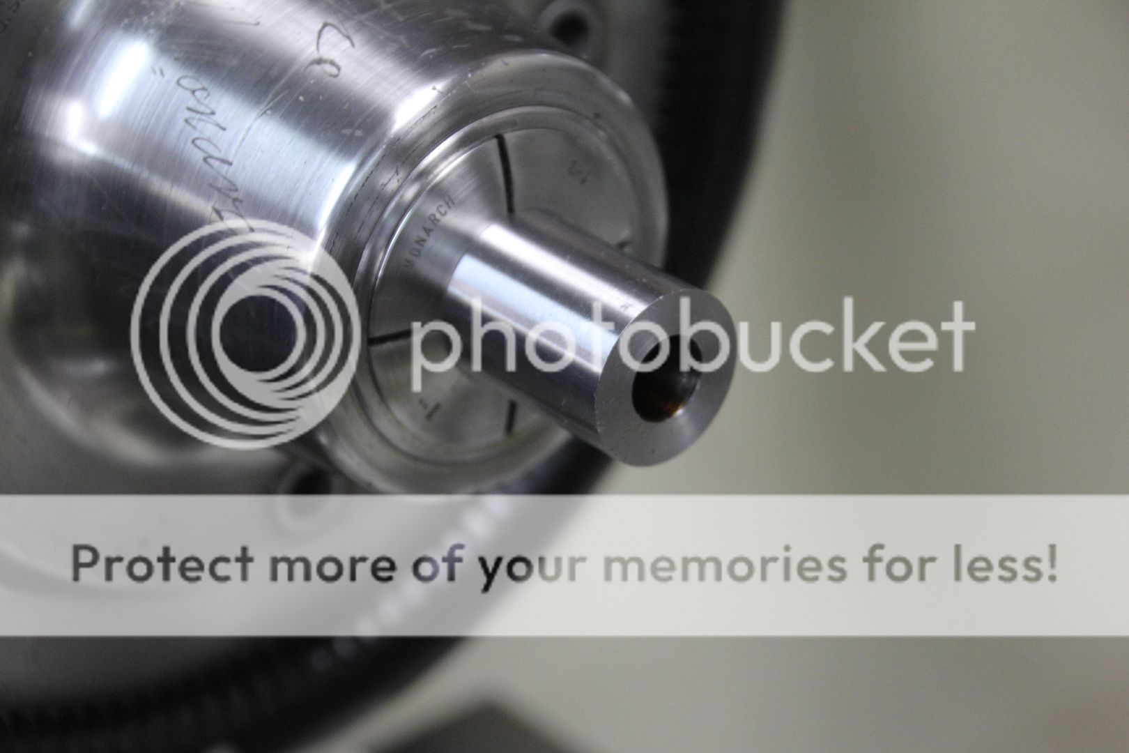

I was never able to produce good groups with bullseye  in the 38.. I don't know of any of the top shooters, back in my PPC days that used bullseye.. I tried..and tried again.. It would not perform to the level of other powders.. 231 and WST are day and night better..Back in those days, we worked very hard at perfecting an accurate 50 yard load to gain an advantage on the competition.. Few powders went untested..and nearly all did better than Bullseye. Now it's a different story with the 45.. I love the stuff for short line especially.
The Model 52 has many issues working against it.  .355 bore diameter and an 18 + twist are major factors to overcome. Plus the bushing system is "far" from ideal..I had a long talk yesterday with one of the old time top AMU smiths.. They had many 52s back in the day...Stating, "The accuracy was always an issue". I believe I can greatly improve the accuracy negatives,  by changing out the  barrel to a 10/12 twist and I have already completed the bushing revamp .  We shall see..Smile

I have the Micro base in place, silver solder and welding is done,  re blued.. and the bushing is worked out.. Top pic is the bushing.. I removed all the factory "junk" and machined a solid full thread contact that uses all the threads and locks against  the slide face.. It's twice as long, locks up tight, and much thicker.. The bottom pic is how the bushing started out..4140.. The middle pic shows the optic base.. I have to make the Micro mount yet.. and the tubes.. The grip panel on the left side is being omitted and an aluminum panel will be in place there to enable the shooter more purchase on the trigger.  Short fingers..Smile We have function tested it... Shot great.. I am still contemplating some ammo modifications..Fun stuff.
