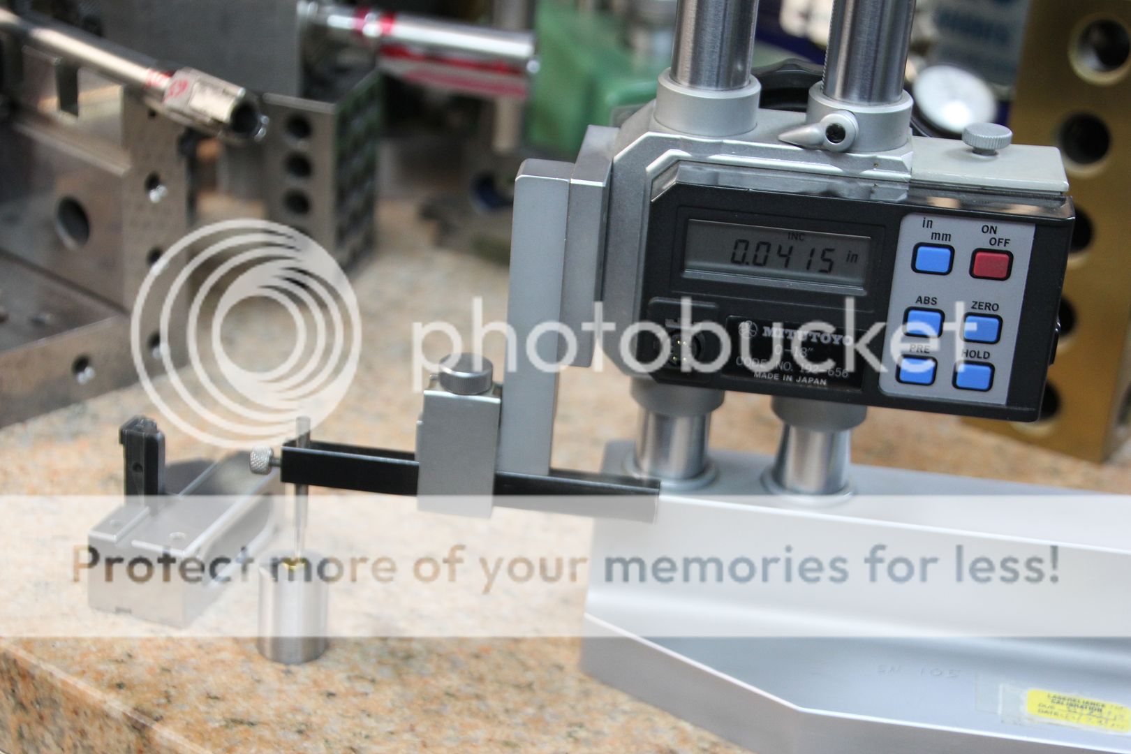

Post by Jerry Keefer on Sun Feb 08, 2015 7:28 pm
Sorry for taking so long.. These fixtures give very accurate repeatable results within tenths...  The 41 breechface on this one is .050.. Not unsual and of course the Eley is .0415 which is very uniform among ERB..

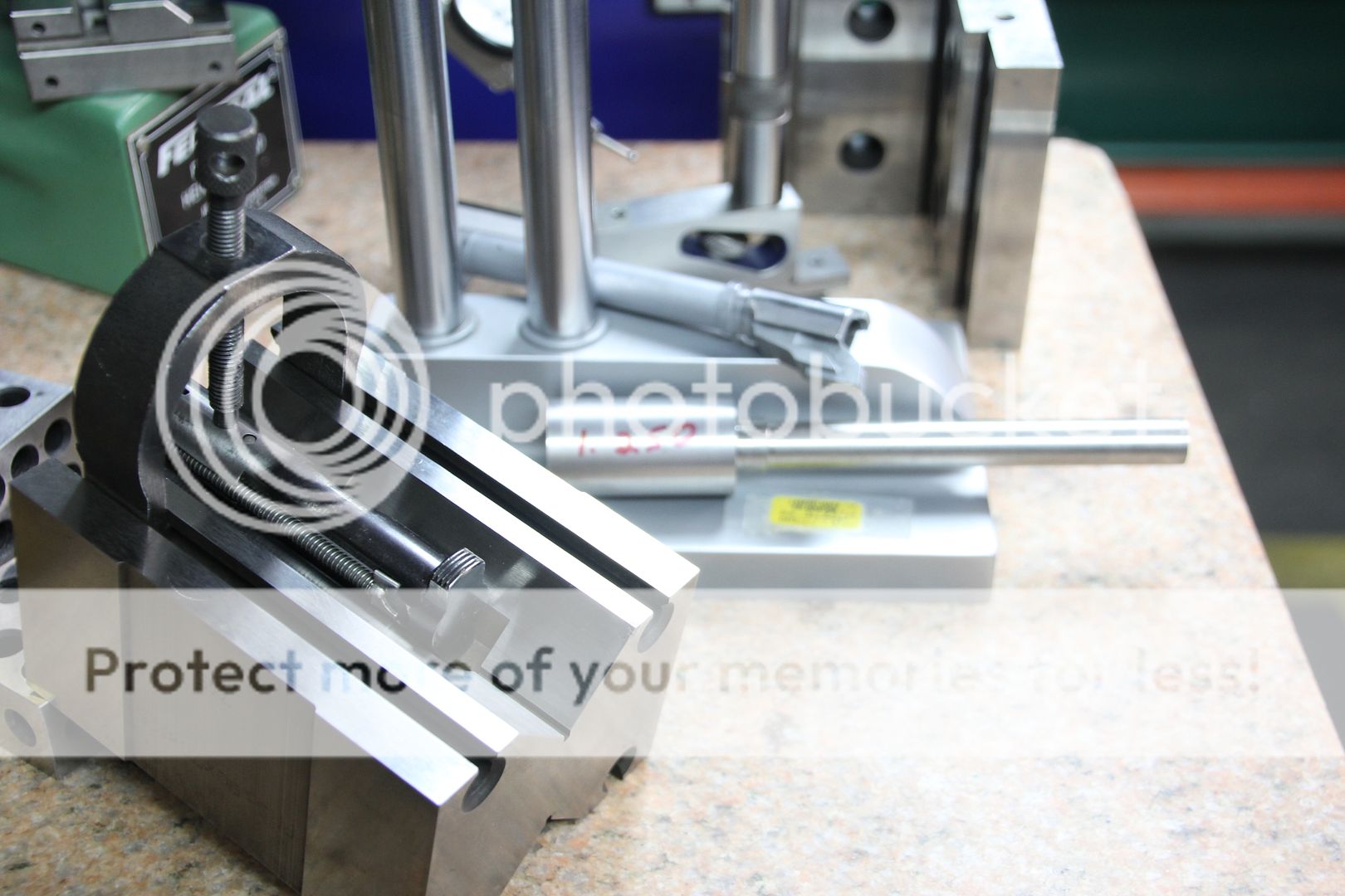

For Ruger bolt faces, I had the large V Block EDMed to clear the cocking lugs. This allows the bolt face to be ground to the desired headspace.
