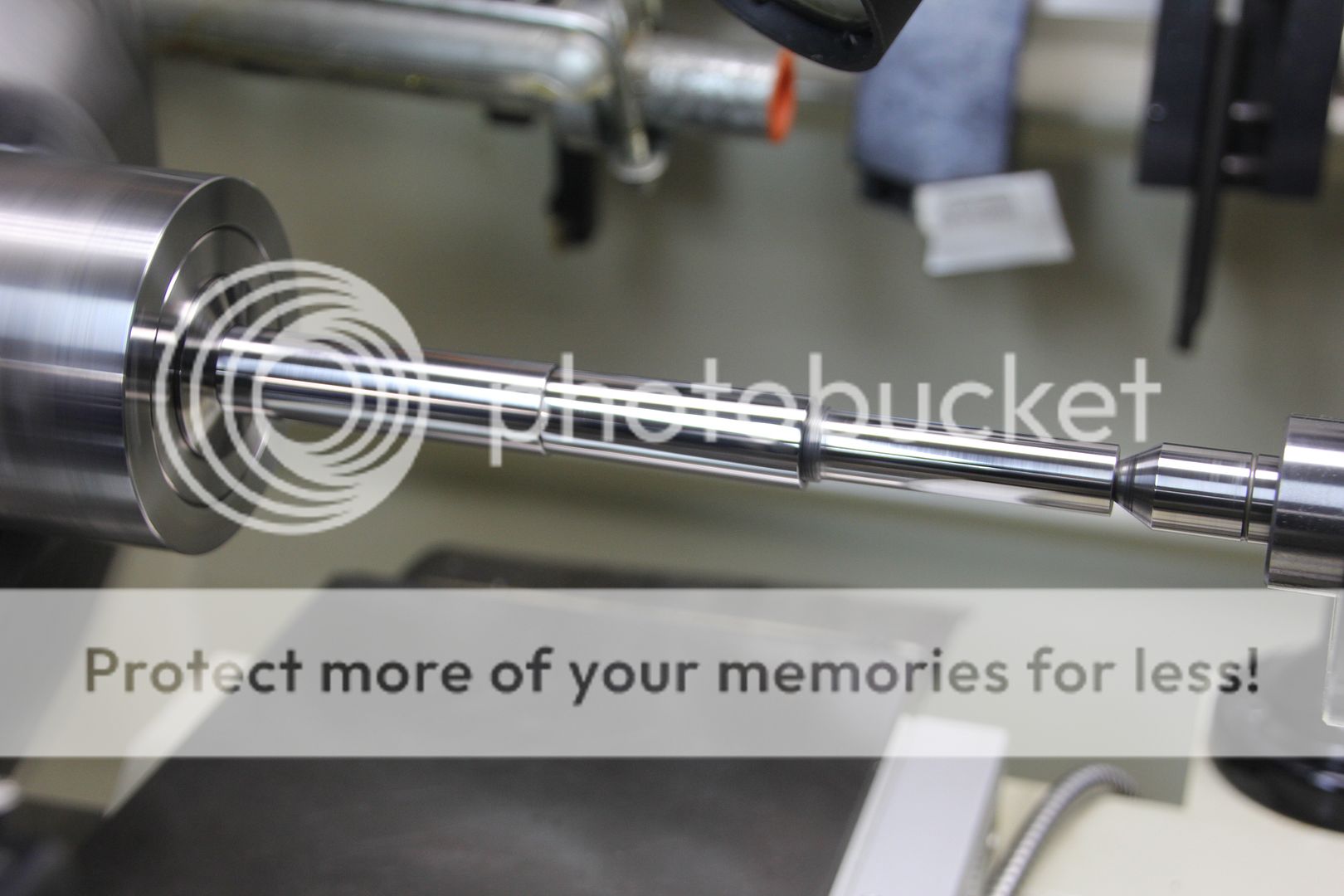

Some where, Jon and I were talking about the two.. I can't find it now.. But here's a pic of a freshly machined cone, ready to install..

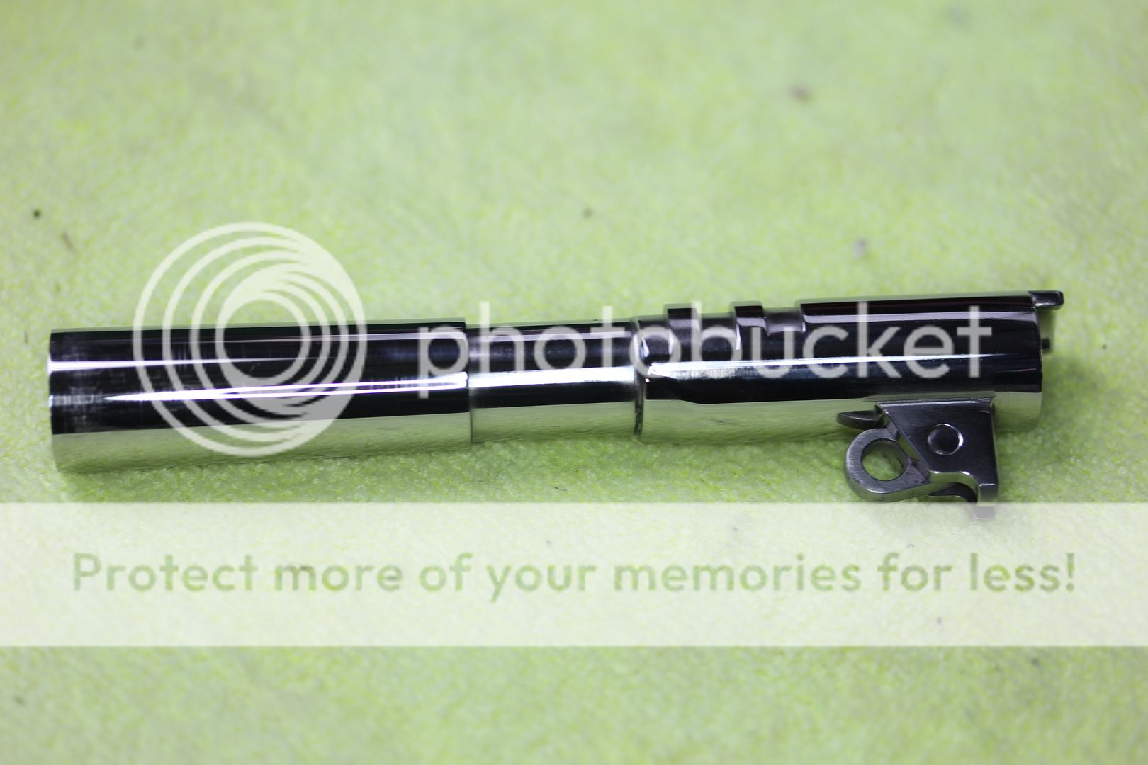

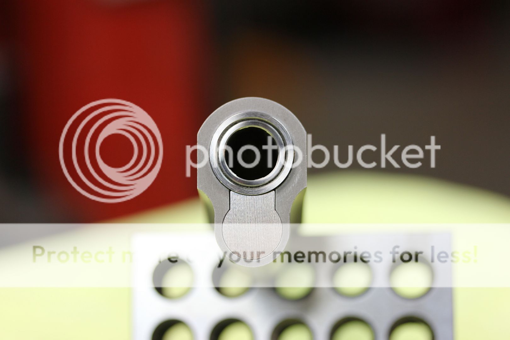

dstates wrote:I'm new to 1911's... does anyone have a cutaway of a cone setup so I can understand the setup better?
Doug
Doug
I'll make a pic of the barrel and cone assembly tomorrow...

Post by Jerry Keefer on 1/29/2015, 11:39 am

Jerry,  What keeps the cone in the slide?  I'm missing that part of the puzzle.

Post by Jerry Keefer on 1/29/2015, 4:54 pm
It's locked onto the barrel..so the slide ID is the bushing..
