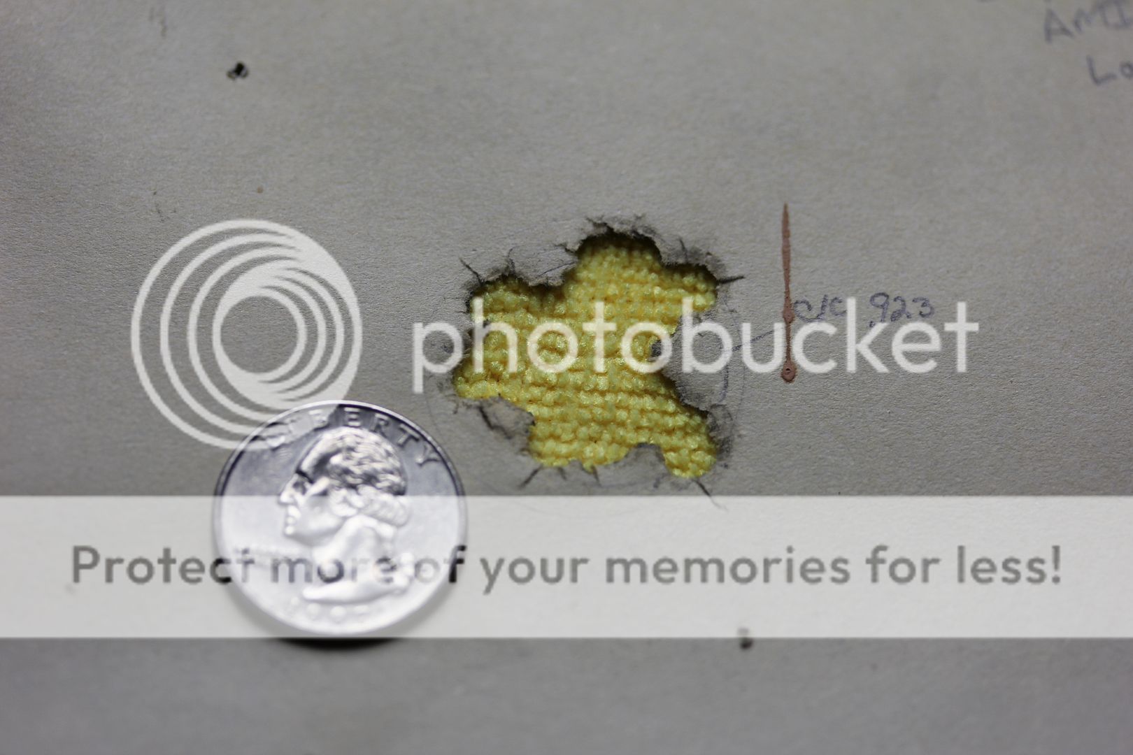

Post by Jerry Keefer on 6/24/2015, 10:53 am
2004 Low velocity AMI Match ammo 147 gr XTP Hornady
1-16 twist Kart barrel  25 shots/50 yard RR c/c  measurement is .923  This has been hanging on my wall for 11 years, hence the dirt and scuff marks..
