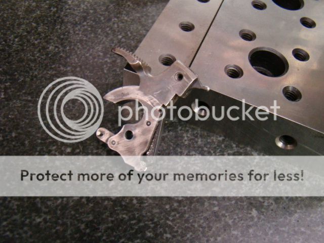

I was going to further comment on mis fires, as I have neglected the issue since it was first posted..
On S&W hammer mounted pins..most all lack protrusion length. I set them all at .060 and polish the pin nose to a very high luster. I favor the sides to slightly flatten them to aid penetration. Do not get over zealous with that..When a firing pin strikes a primer, the cup metal is in motion, and must have a place to go. It will flow around a contoured polished pin much easier, and allow the pin to travel further into the primer.   I also check the hammer face contact marks.. If it is not making square contact, when facing off for the pin distance, I true it up to strike the frame as square as possible. I also check the bushing for bind.. The pin nose should pass thru the bushing with zero resistance.
When the hammer is held completely forward solid against the frame.. The pin should be free /  loose within the bushing.
Inside the frame, the rebound block and hammer camming surfaces should completely clear each other, at hammer down, trigger to the rear.. If they make contact even slightly, mis fires will occur. I change the angles on the rebound block to compliment this condition, and also give the rebound spring a running start on the hammer.. A much lighter rebound can often be run when the angles are changed.. A surface grinder and precision compound vise is about the only way to do that accurately. I remove the spur from all PPC revolvers... But to compensate for the weight loss of the above the rotating axis.. I remove a larger amount of weight as low  on the hammer as possible. This speeds the hammer up, and helps to retains the original rotating mass ratio near the pin.  Note the pic..This hammer has not had the spur removed, or other work done at this point..
