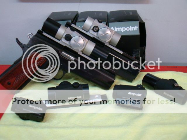

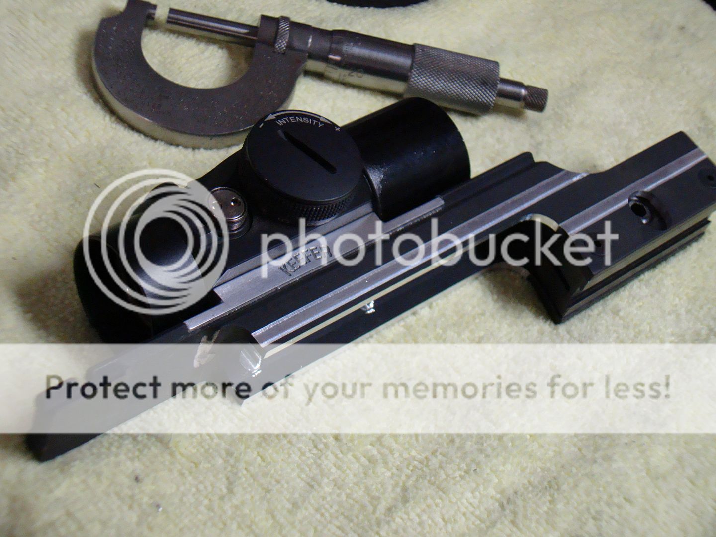

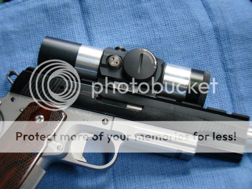

Here are a few pics.. The only popular bullseye gun I haven't done is the AW.. Never saw one..So I can't say.
Top pic is a Kart with an Ultra Dot... next a Hammerli with a Micro, and last a Marvel with a Micro.

When planning this initially, there had to be a method to change out a defective optic in a reasonable amount of time..On the 1911 mounts, the extension tubes are removed to provide access to the base retaining bolts.  I use #12 counter sunk bolts, which extend into and thru the slide. The base is a light press fit into the rib which absorbs the recoil.

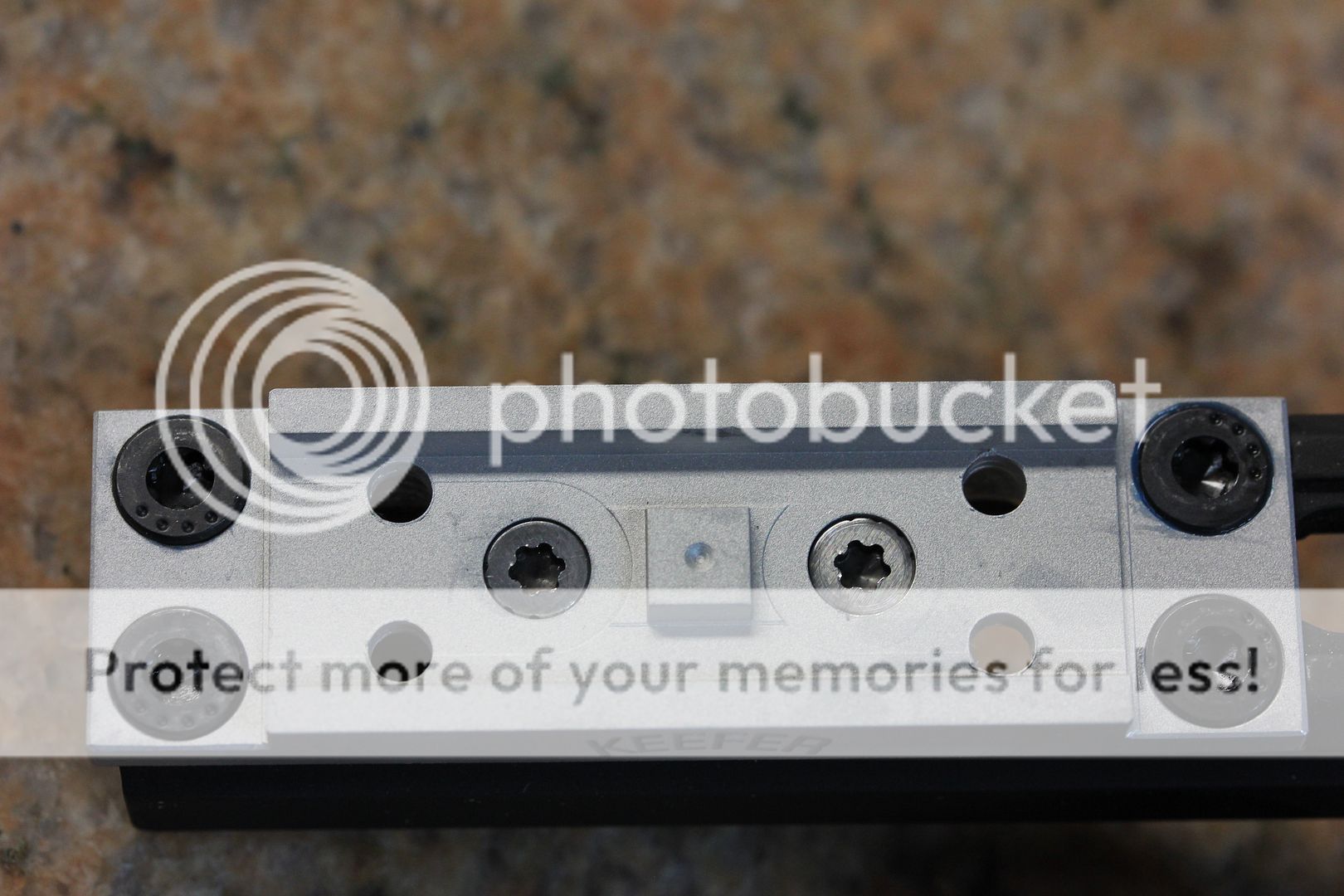

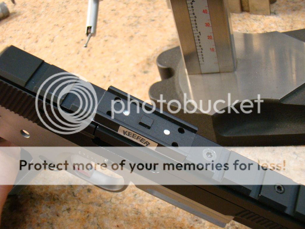

The next two pics are for the Hammerli. There is no need to remove the base plate. It is secured with 6 Torx heads.. The entire scope mount is removed from the gun, and the four small Trox Micro retaining screws are removed..
Notice the inside contour of the  base plate.. These internal dimensions are super critical. The sides are 20 degrees. The small recoil stud in the center must fit into the scope base with absolute minimum tolerance to insure the scope remains secure. Its position is key to the screw hole C/L s and the tapered sides must be cut to create a very light press fit  between the scope and the base. So, to answer the conversion rear rib question.. There is not enough material to machine the Micro into that area.
This Marvel base is about as far back as you can get it, and retain max strength. The pocket the base fits into is a friction metal to metal tap in fit for maximum strength.
