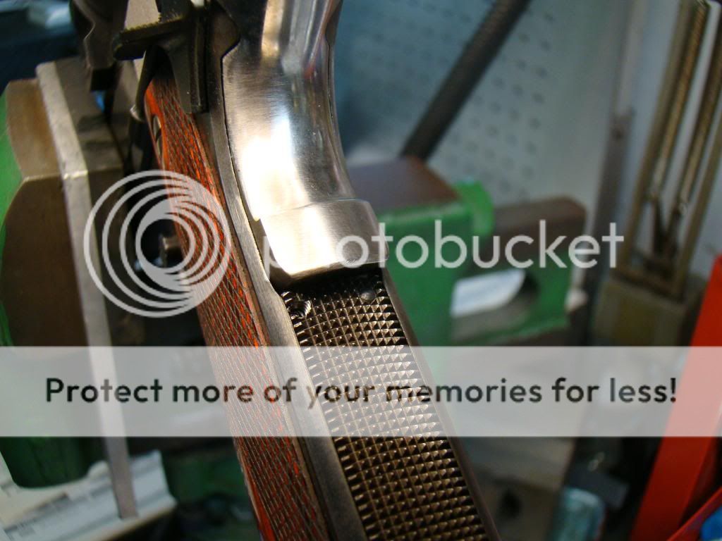

Post by Jerry Keefer Wed 18 Mar 2015, 3:07 pm
The trigger on the 1911 is not a precision target system. We do the best we can, but it leaves much to be desired.. The sear spring is trapped by the main spring housing, which limits the sear springs ability to flex.
I relieve the housing to allow more range of motion.. It produces a more repeatable condition. Bending the spring leaf can drive you nuts. It's like playing the lottery.. Hit & miss, mostly 99.9% miss. Then it changes, so I avoid bending if possible, and adjust with a screw in the main spring housing.. It's easier, and seems to last much longer.  Not allowed on CMP guns, but I don't build them any longer, so lucky me..
