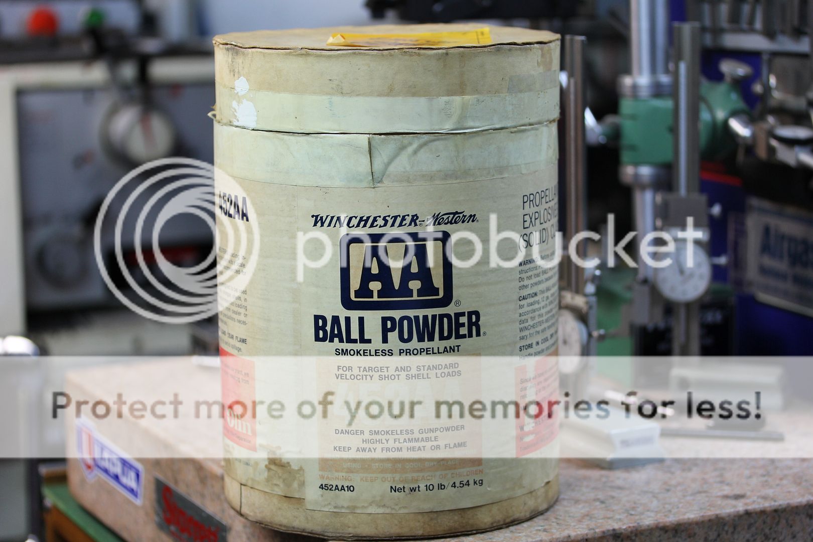

Post by Jerry Keefer on 11/4/2015, 7:44 pm
Original stuff.. Full to the brim..
It has no physical resemblance to WST at all.. It is a true ball powder.

Post by Jerry Keefer on 11/5/2015, 3:35 pm
Ah...Very nice pristine can... Yes, the granules look identical to mine.
