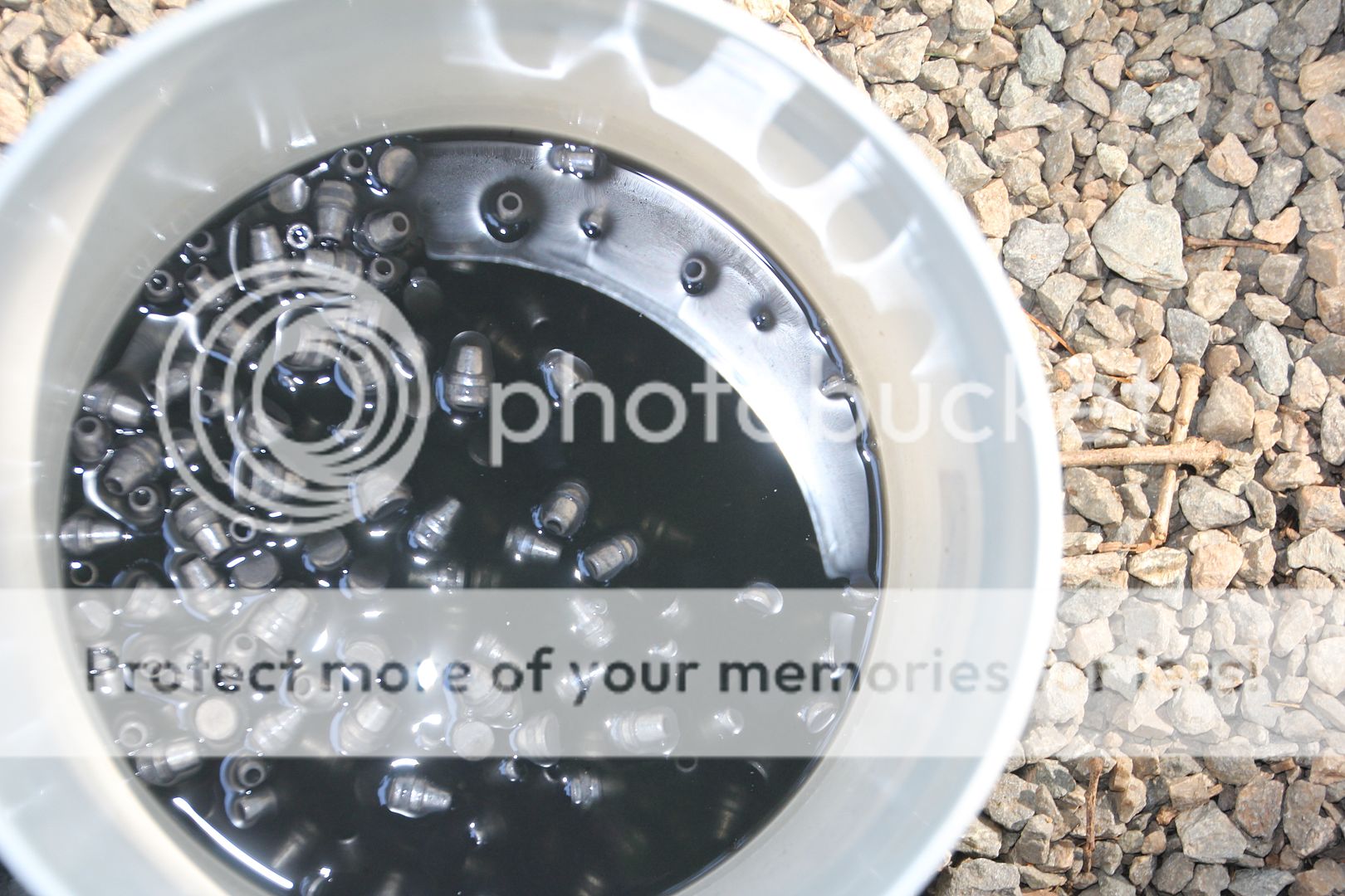

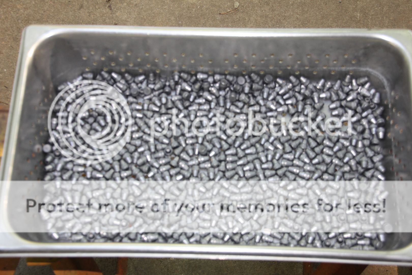

The black goo on Star bullets is gasoline soluble. 2 hours in the hot sun and it is completely dissolved.  Bullets are dried in the sun .. Tomorrow new lube.. and we'll set them over some 452AA and see how they perform..  This is the last..about 1000.. It is either use them, or donate to the Smithsonian..Kept them around to settle inquires about BN..All Stars I have tested are in the 8 range.. Soft..too soft in my book..
