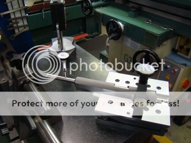

Some where, I have an angle bore from EGW..Can't find it.. I love George's parts and innovation, he's always ahead of the curve,  but I didn't care for the double angle bore for bullseye. I think it takes away to much bearing surface.  But that's just me.. It might work great for you.. When I angle bored bushings, I fit the barrel with a tight Briley.. Then I locked the barrel to the slide, mounted it on a sine plate, and measured the angle of lock up.. Then I used that to bore the angle.. The 52' minute thing is arbitrary..  But now... I am all cone..Smile
