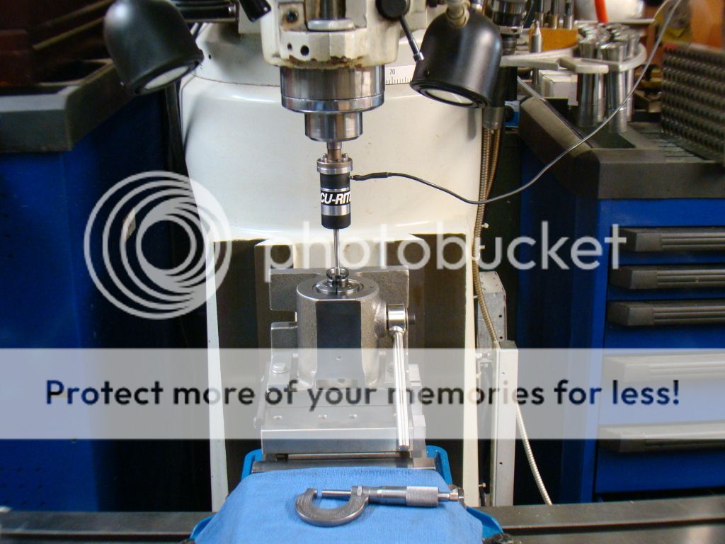

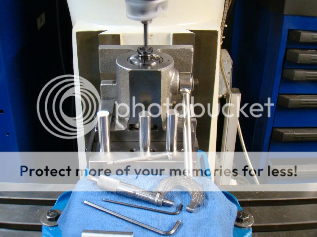

Post by Jerry Keefer on Fri Jun 24, 2016 9:29 pm
Wes Lorenz wrote:Hi Jerry,
If you only angle bore your bushing to the actual barrel angle,
Wes
It will go into battery, but it won't unlock..The exact angle will not work.. But, if you divide the sine bar vertical "H" by 2 and bore that angle in a back bored bushing, that leaves approx. .100 land,  it work great..and you can run a nearly metal to metal clearance.
EGW thick flange gunsmith fit are the very best bushings.
I turn the OD first
Then I take a truing skin and then back bore
Into a collet fixture mounted on another sine plate set at the calculated angle and zero is established..
Then bore...I love boring, it is sooo precise.. Smile
