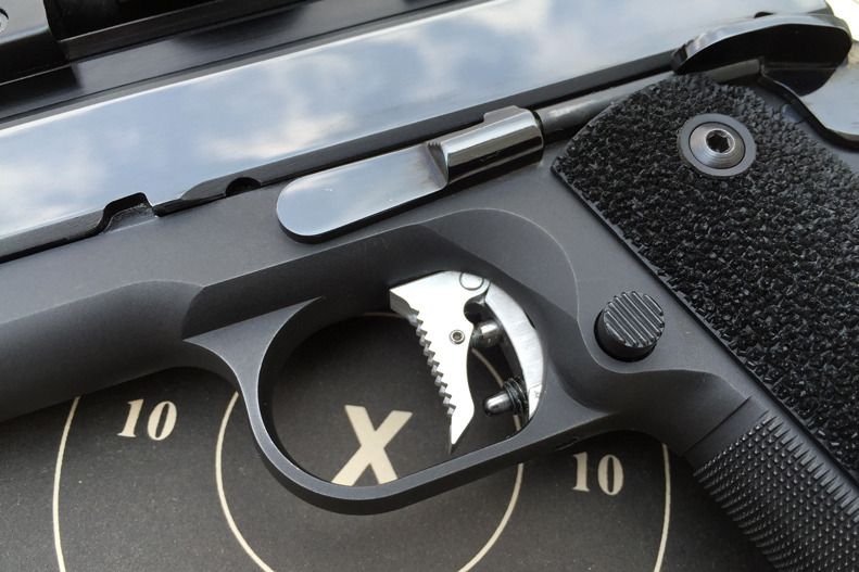

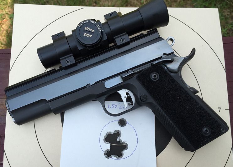

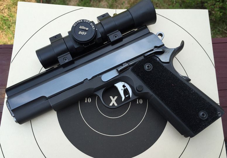

I just finished putting together this new Wad Gun for myself. Its a Caspian frame, STI slide and Kart barrel. Im not a professional gunsmith, just a hobby for me, but Im pleased with the results. Had an unexpected day off today, so took it to the range, Just got home from Ransom Rest testing at 50 yards, and the gun is holding 10 shot groups under 1.75".
 The big difference, as you can see from the pictures, is the trigger. I learned about this trigger from a post on another gun forum. Its an X-Line trigger.
Here is a link...http://www.xline-geppert.de/x-line%20trigger.htm
 I contacted the manufacturer in Germany. He is a Bianchi Cup Shooter,  and was very pleasant and helpful in Emails, So I placed an order. If you are familiar with the operation of the fire control group of a 1911, the pics on the X-Line site will answer a lot of questions. Its adjustable in almost every way (so much so, you can go a little crazy playing with all the adjustments). The spring loaded plunger behind the lower part of the trigger can be moved in and out for a long smooth single stage roll, or set up like a two stage feeling trigger, which is how I have it set up. I have a sear cut on a True Radius jig, with a Wilson hammer that has long-ish hooks. The body of the trigger doesn't move, it is secured in the frame with a set screw through the trigger guard.
 There is basically no take up, as you begin to pull the trigger, you start rolling the sear off the hammer hooks (movement is amplified by the hinged design). Just before the sear releases the hammer, the trigger hits the adjustable plunger. It has an internal spring that you can vary the weight of. Continued pressure will release the hammer with very little further movement. Initial pull of mine is 2 pounds for the first "stage", and 1.5 more for the second.
 With a properly polished and mated sear and hammer, the pull is very consistent. Because of the leverage gained by the hinged trigger, the sear spring is set up for a trigger pull more like 4.5-5 lbs. Results in a pull just a hair over 3.5
 I thought it was a pretty neat idea, and well executed, So I figured Id share it with you guys. Gives the old 1911 a "euro-gun" feel.  Ive only used the frame for a 22 match at this point, so the jury is still out, but so far so good.
 Its not a cure for poor trigger control, its just something different to try. If you like the feel of a two stage trigger in your .22, you might just like it in your .45.
 What I like about it, is it gives you a chance to experiment with different types of trigger pulls with just a few adjustments! cool.  If anyone has any questions, Ill do my best to answer them. Here are a few pictures...

It's really up to you. I always like good solid reset, so I put plenty of weight on the center disconnector spring.  The trigger was designed for Bianchi cup, so I would think it would be good for steel.
Remember, this trigger( like any part) only gives you  what the installer chooses to get out of it.  If that makes sense.  The extra leverage allows you to set the sear spring heavier than you normally could for the same trigger pull. If you are not careful, you could wind up with an EXTREMELY light  trigger.

Really depends on how you look at it if you call it an improvement or just "different ".  I had hoped to see some improvements in my slow fire scores, but really, all my scores just stagnated this season. I don't blame the trigger, I took it off and went back to a traditional trigger and nothing improved. Only in the last few matches have I started to see some progress. It's been a pretty frustrating season!! I really like the feel of the trigger, I didn't find it difficult to adapt too and could see that if I keep all my fundamentals squared away, it would be an asset. I've got a frame and a few parts I'm going to build into a dedicated .22 lower over the winter and this trigger will be used in that build. I'll update this thread when I have more info.

Ive been away from the forum for a while and just saw this thread alive again. I like the trigger, Its biggest advantage is it can "feel" like a two stage trigger. Personally I found it difficult to make the pull heavy enough. As stated, it needs to be measured 1/4" from the bottom. Even when made legal weight, in my opinion, it feels much lighter.
 Last year my scores just hit a brick wall at 800-810, and I decided to really try and focus on some basic fundamentals so I removed the trigger so all guns would have the same feel.
 I milled the trigger shoe to a more curved and smooth shape, feels much better, and will probably put it in my 22 conversion frame later this year, but want to get a few matches under my belt first. If I was smart, Id just not mess with anything and shoot, but we all get different things from this game, and I really enjoy experimenting, sometimes even at the expense of my scores, again, thats just me.
