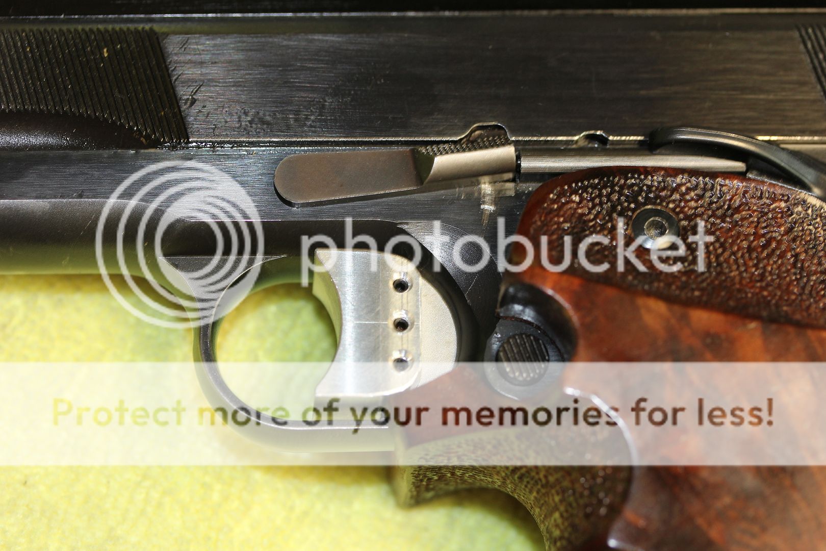

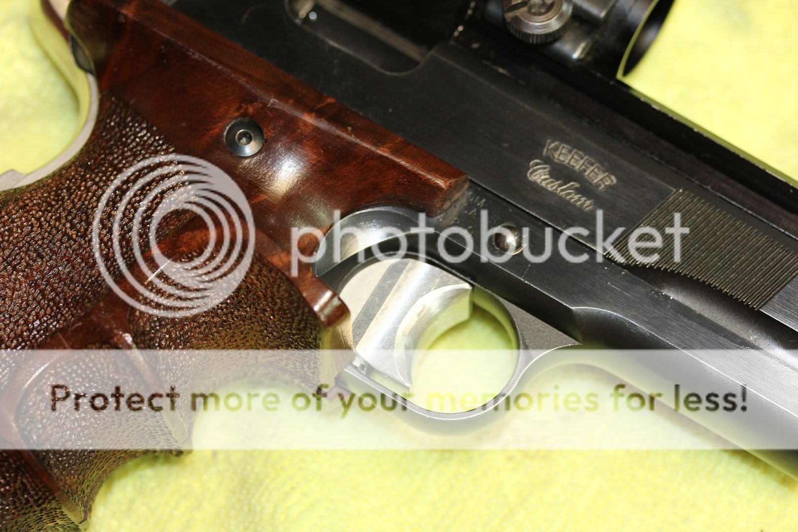

To give an idea of one method..Christopher Miceli wrote:Yeah mine I would say is a medium roll? I'm looking for a trigger shoe cause I think it will help with the travel.
6061 Aluminum
I make a lot of trigger shoes, but not for general sales.. I cut the trigger face flat.. No curve. That allows a flat straight groove in the back of the shoe for solid tight contact.. No rocking forces from the old style Ace type shoes. It also allows for a solid simple zero base line. Some shooters want several shoes to use for different lengths. This shooter has exceptionally long fingers. This is the initial prototype which was later reduce by .060 .. He will shoot it for a while to see how it works.. Change is simple with the flat groove in the back.. The three screws mate with countersinks in the main shoe for a very secure fit. The radius is approx. .610 for the shoe face..
