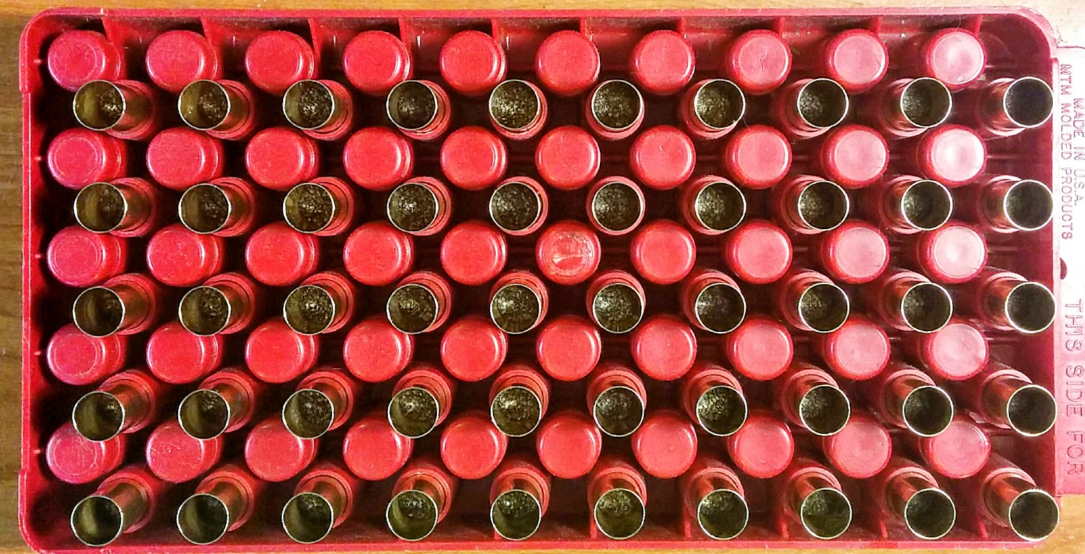

okay i pulled 50 of the SPP rounds that went  pppffffttttt and slung the bullet REAL SLOW down range
I have to ask...Large vs small Primers - Page 2 NWSCdI
i see the proper amount of powder in each and every one
so SPP low volume,low weight charges = not so good
now im going to put those back together and run them to see what else they will do

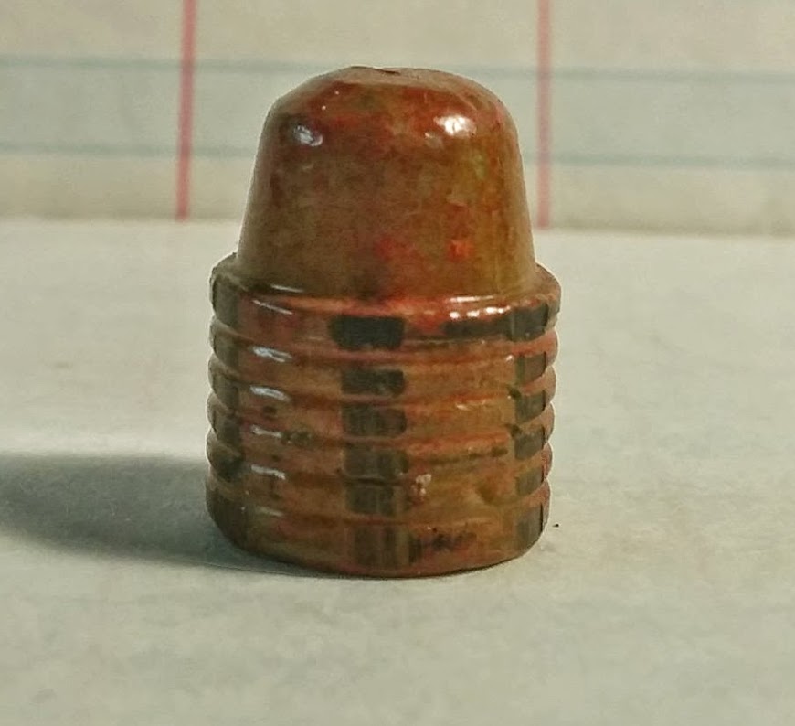

i forgot i found this down on the berm
so i bet everyone of them made it down there
I have to ask...Large vs small Primers - Page 2 FziZRU
primer fails with low charge of fast powder

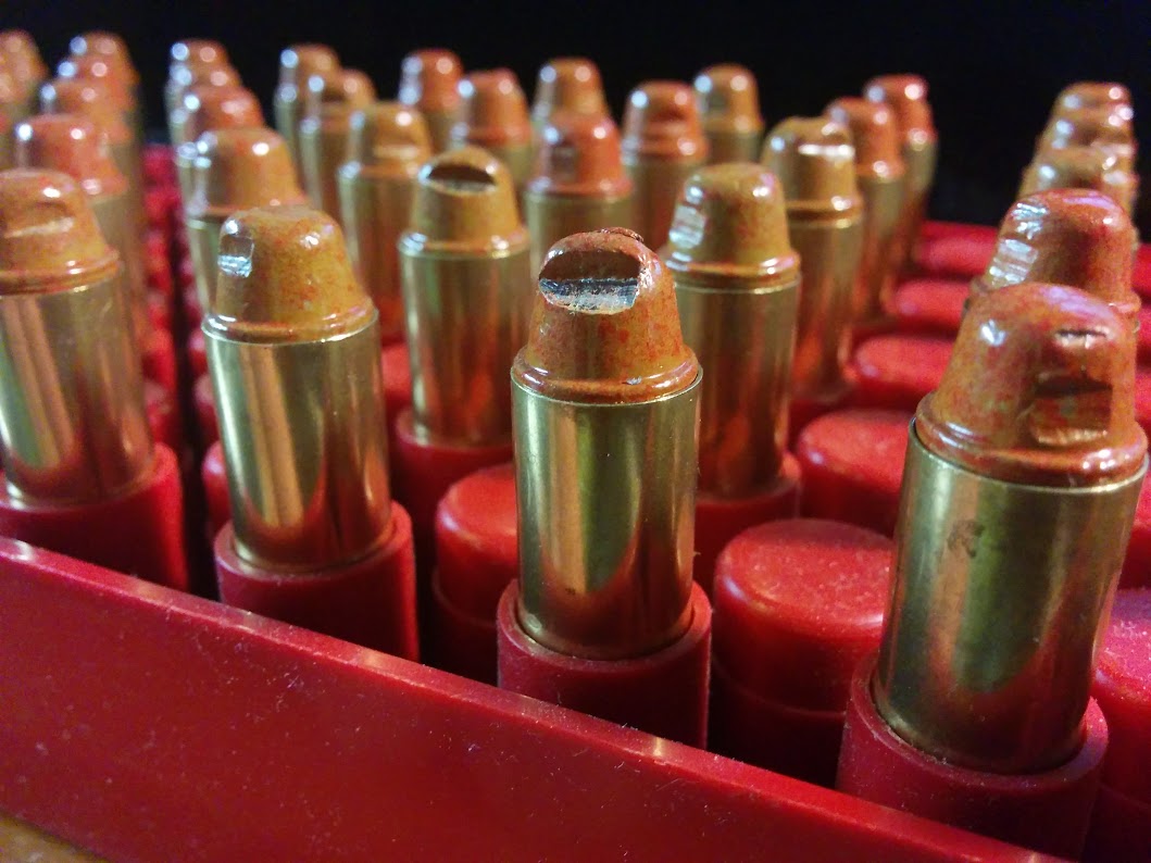

darn... i already rebelled and put the divited bullets back in
I have to ask...Large vs small Primers - Page 2 BN0Cmt
ill bet at 25yds  those wont bother a bit
yup i run SOFT lead

I don't see a crimp line. I actually see a gap. That could cause psssst.
Posts : 4663
I have to ask...Large vs small Primers - Page 2 Empty Re: I have to ask...Large vs small Primers
Post by guncheese Sat Aug 15, 2015 10:40 pm
well they havent been reseated
and thusly not crimped Wink

Back to keeping it in perspective. Guncheese had a legitimate response to the OP. He ran a batch of bullets with small primers and bullseye powder and had failure to ignite problems. If the problem is purely the small primers then the answer is "Yes" there is a problem with small primers. I asked about his crimp to narrow it down to the primers being the problem. I don't see how it could be more in perspective then that.

1. Your 3.4gr charge is really low.  There are some classic loads that low but they didn't use powdercoated projectiles
2.  The bullet that you recovered doesn't have any marks from the grooves--just the lands.  Are these bullets undersized and not sealing to the bore?  What were these bullets sized to? What do they measure now with the powdercoating on it?
3.  What sort of powder measure are you using?  Are you sure you have consistent charge weights?  It's hard to tell visually that you are consistent when you are cooking a 3.4gr recipe.
I want to figure out why the bullets don't look like they obturate.
