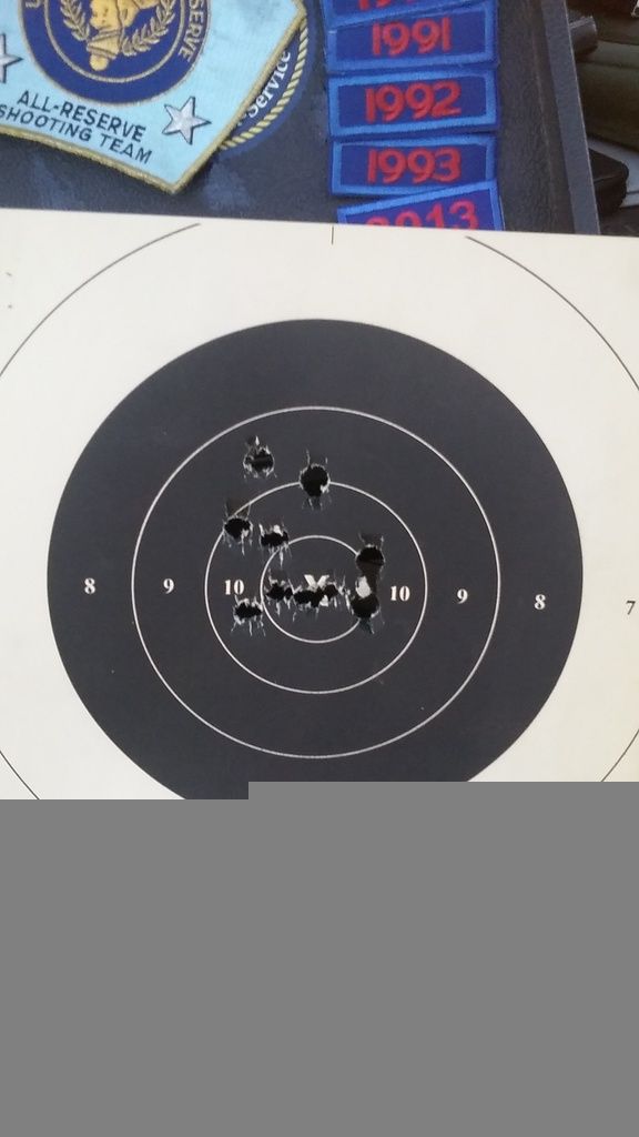

Had an opportunity to shoot some of igolat8's coated bullets. They leave the bore shiny clean and shoot darn good. Shortline was just a nice knot and 50 yds was on call. Used 4.2 gr 700x @ 50 and 3.2 gr @ 25. Going to shoot a match with some this weekend.

A couple months ago I did ransom rest testing with Bob Palermo's coated 200 gr SWC'S in my SA wad gun. They grouped 2.5 inches at 50 yards. The same bullets, uncoated group 1.5 inches.
