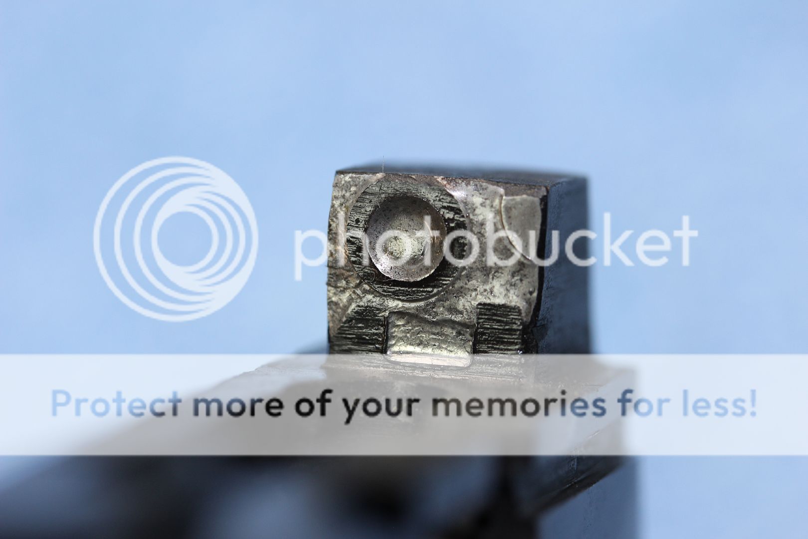

Post by Jerry Keefer on Sun Dec 20, 2015 10:31 am
Tim:H11 wrote:I found this to be an interesting and enlightening thread. I'm curious now though about other .22LR Rimfire pistols as well. Say the Ruger MK series or the Smith and Weson Model 41, or even a Colt Woodsman Match Target. Can they be sensitive to ammunition loaded to velocities higher than that of "standard velocity" in a way that will eventually cause damage or exsesive wear to parts such as the frame and or slide? Don't mean to high jack the topic, sorry!
A cracked S&W 41 slide and a high round count High Standard frame..

Post by GrumpyOldMan on Tue Dec 22, 2015 1:56 am
Jerry:
THANKS for posting how they fail, which of course tells us what to look for.
It would seem that the S&W slide crack is a much easier fix than the H-S frame letting go. My mental gears are turning and every crazy idea to "product improvement program" upgrade the H-S frame is running into a "can't do THAT" problem. Wonder if just a frame re-design adding .05 inch thickness to the left side would do it???
I'm seeing problems with rotational stress on both failure modes.
Perhaps introducing a paradoxical solution of less slide mass, changing its distribution around the centerline of deceleration, and maybe even adding mass on the other side (vertically) of the rearward slam-stop line?
On the H-S, one of my first wonderings was about doubling the mass behind that peened-up stop boss where the slide bangs. But that would probably make the rear end look oooogly..or add mass forward...???
Either might respond well to a double spring arrangement where a secondary spring which engages AFTER case ejection to drastically reduce the slam backwards thing...
There's gotta be a way.

Post by Jerry Keefer on Tue Dec 22, 2015 9:48 am
Grumpy
A major part of the issue is failure to follow basic design and machining pratices...Radius and fillets are missing in every case. The surface finish of the interior of the HS is just shameful...sharp corners every where. Cracks/stress risers waiting to happen. All 41 s could use a larger radius in the cracked area.. I repaired that slide with a generous radius, and radiused the barrel to match.  It's now running well.  Someday, I will make a weld repair attempt on the HS frame.. The owner is a super High Master, who now uses Hammerlis, so there's no rush..SmileSmileSmile
Re: 22 hv vs sv
Post by Wobbley on Tue Dec 22, 2015 9:53 am
There is not enough information to pinpoint the precise cause.  But one place to look is the broached opening through the top rail for the magazine.  There seems to be a decided sharp corner where the ejector protrudes.  If that can be made tangent I bet the issue is reduced.

Post by Jerry Keefer on Tue Dec 22, 2015 10:30 am
Wobbley wrote:There is not enough information to pinpoint the precise cause.
Repetitive shock....
Re: 22 hv vs sv
Post by Jack H on Tue Dec 22, 2015 11:19 am
Worst HS frame break I saw was a Victor broken on both sides like Jerry's pictured one.  The one I saw even had chips of the thin metal on the left missing.  Front half and rear half of the frame was held together only by the metal on one side at the bottom of the grip.  And it was still operable.
The first break is always on the right side like pictures show at the slide stop cutout.  I have smoothed the edges there and at the right rear corner of the magwell.  The real insurance is to use SV ammo, and spring maintenance.
Posts : 1582
Re: 22 hv vs sv
Post by Wobbley on Tue Dec 22, 2015 12:28 pm
Ok.  Where did the crack start?  Any metallurgical analysis (hardness to spec, alloy used correct, etc),  This all part of failure analysis to point to the precise cause.  First looks are not always correct.
Since the desire is to not destroy the frame, the precise cause cannot be determined.  However I do agree that the machining is poor and far too many sharp corners are left.
Posts : 1623
