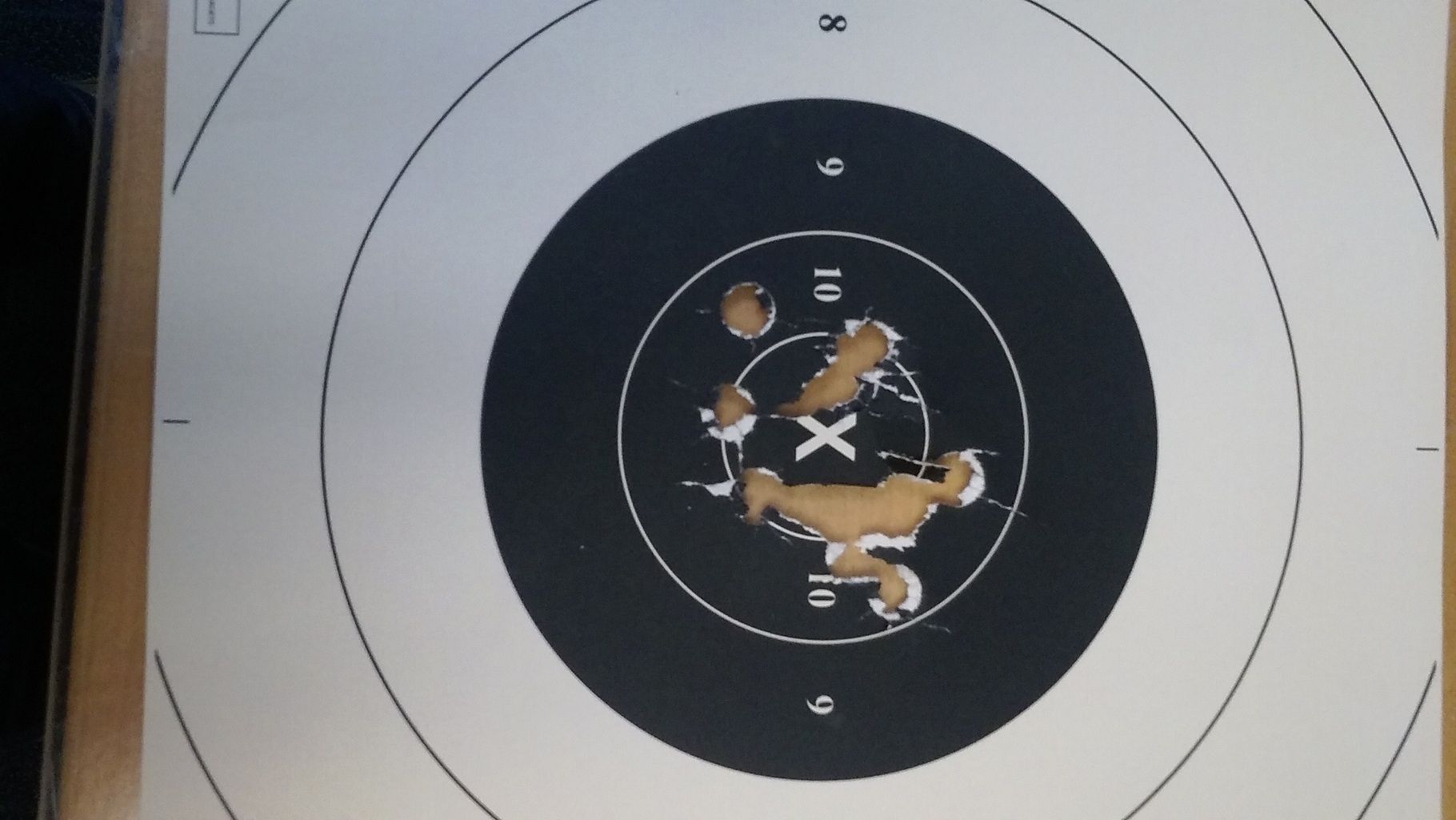

I shot a match last weekend. First time shooting my .45 in about 5 months. No practice for match. Last match I had shot was in early November. I share this because I think its important to show the foregiveness of reduced loads.
I was shooting 3.3gr Bullseye with 200 gr Magnus LSWC.
To me these are not bragging targets, I've shot much better. They are just to show what you can do using reduced powder charge.
I did change recoil springs from long line load.
I encourage you to try this for yourself if you haven't already.
I suck at posting pictures so I apologize in advance.
The first target is a RF target (upside down).
The second target is a TF target (bottom to left).
Iurl=][url=]

When I grow up, I want to shoot like that.  Smile

I'm willing to bet someone was unhappy about that 9.  Me on the other hand would have to wonder who was shooting at my target.

hmm... you make me rethink shooting only JHP    Shocked

After those targets, does he have any bullets left to sell??? Lol

Get your X-count up.

Nice targets!!  I would be vary happy with those!!!

If your pistol is up to it, this is an indication of what is possible with Magnus bullets.  Other makes are OK but Magnus and Zero and a few others perform at this level.

The load/technical point Jon's making is good.  Especially if there's been a great amount time between practice on the short line.  However, when I see targets like he posted and the extended time between match's/practice's (there's a guy like this on my team) it makes me believe we shoot with our brains more than our bodies.
All skills are perishable, but Jon's to the point where his brain knows what to do (very, very well) even if all the parts on his body haven't done it in a while.
