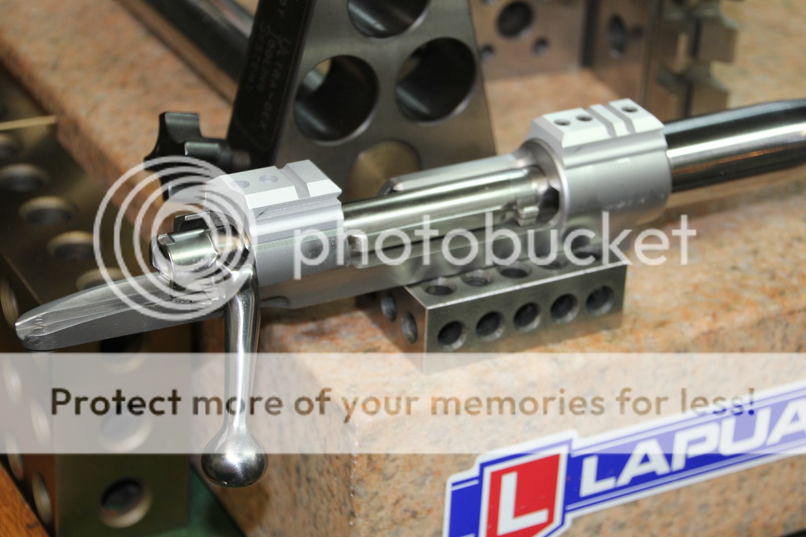

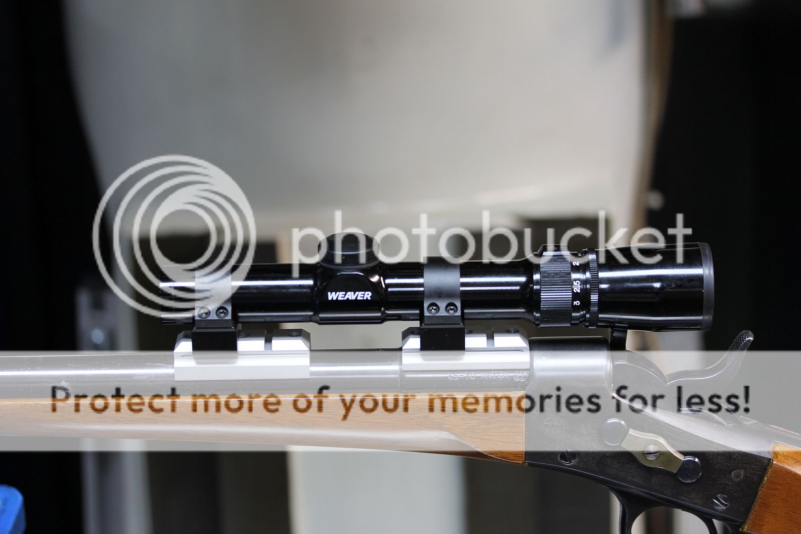

I have made countless scope bases machined on the receivers such as these.. I can't do enough of them to meet the demand.. Years worth.. From Police Swat Teams to hunters and some target shooters from 6061 and not one has ever failed..NOT ONE..

That's one reason I use it.. If one of those bases by chance should break, I can weld it up and recycle it back into service.
I have some Krytonite on order, but it has been placed on back order.. I also have a hook at Cabot.. They are now using meteorites, and I hope to get a chunk to try soon..
Incidentally, there is a sub forum on Face Book, called Firearms Machinist... many of those guys are at the very top of the heap..nice place to share your photos.. Give them try...
