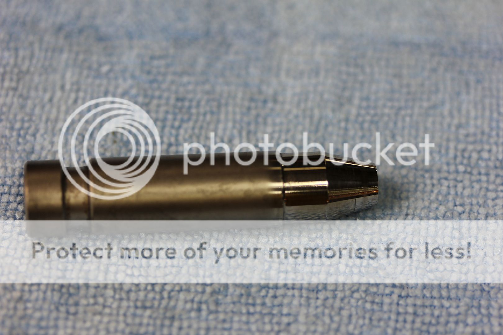

Re: Dillon powder funnel sticking
Post by Chris Miceli on Tue Feb 09, 2016 12:22 pm
This is after i took a scotchbrite pad to it. You can kinda see the lines where it is catching.
Posts : 1688
Location : Haymarket, VA
Post by Jerry Keefer on Tue Feb 09, 2016 12:41 pm
Oh.. I see how that can create a problem..This is  an old 1050 part
