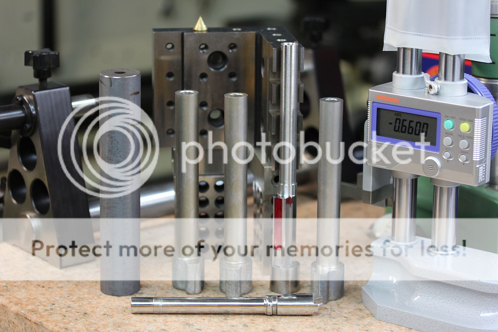

Post by Jerry Keefer on Fri 12 Feb 2016, 15:11
True blanks, no chambers, upper or lower lugs.. These are going to be single upper lug barrels..for Bullseye  Interesting concept initiated by Chuck Warner.. We have been shooting a one lug 45 since Sept. 15

Complete control of the machining process, which means, control of all C/L axis.. the barrel should be built from the bore C/L out.  The chamber can be single pointed to within several thousandths, and then reamed in a spider to attempt absolute concentricity. You can't do that with after market barrels..  The lugs, both upper and lower  can be controlled..All those will have one upper  lug.
Dr. Don, those complete 1911 blanks are in the mid 40s if I recall. The 52  is turned from a Douglas blank which carbide cutters were used.. It was hard on HS cutters..I am not sure of the RC on the Douglas but it is tough...   The lugs when fit tight between the breechface and slide lug really are not subjected to heavy wear, because nothing is moving under pressure.. 9 out of 10 1911s are running on the first lug.. I cut the lugs off my lady shooters 45 in Sept. and it has been running all winter like a Swiss watch.. ..

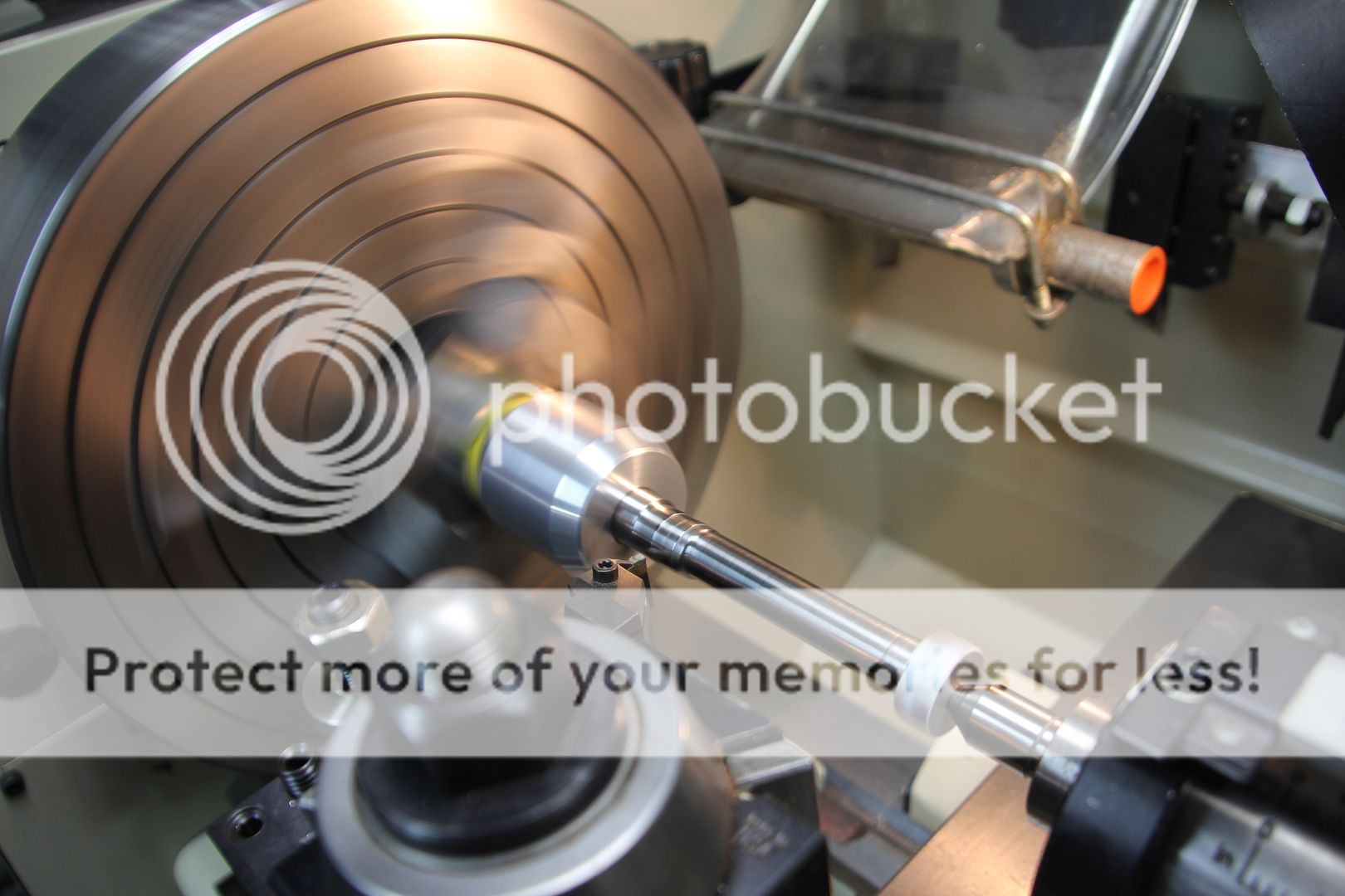

Here's a shot of the lugless 52 barrel.. It's coming along nicely..I enjoy the challenge of R&D
I am running out of time, so I stopped taking in work, so I could devote all my time to experimenting..SmileSmile
