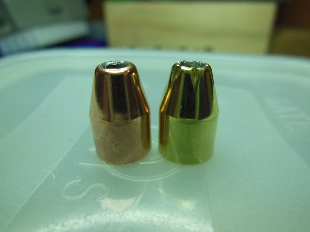

Here are the bullet profiles, HAP on the left.   Notice the flutes in the Montana Gold nose; also the HAP base is flat and the MG base concave.   The range data is on the next reply because I've not figured out how to send more than one photo being the Luddite I am.    some bullet Weight Data Hornady%20Montana%20Gold_zpsjumk4t0d
