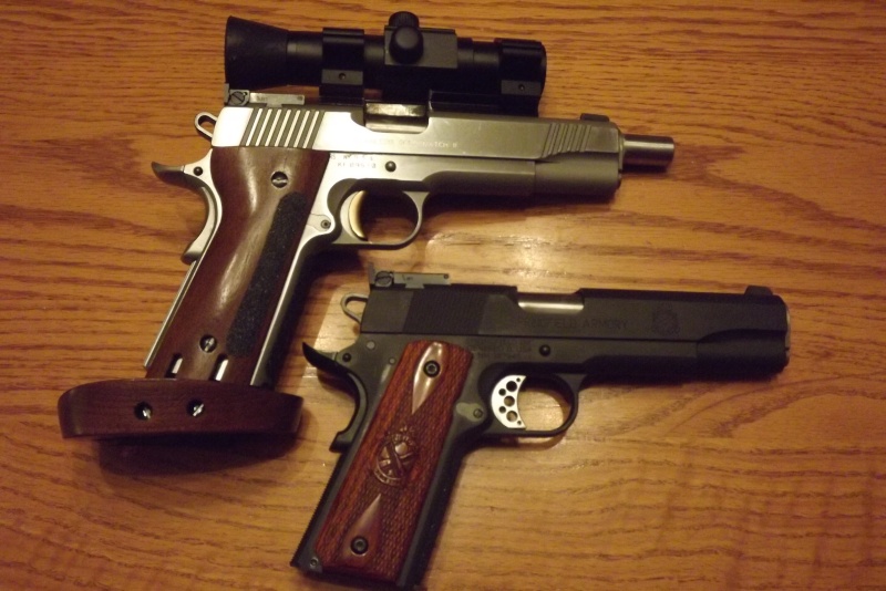

For quite awhile now I have wanted to see how my RO would shoot if I converted it to a 38 super. I found a nice deal on a 6" Storm lake barrel and decided to give it a try. The barrel was supposed to be a drop in so I wasn't worried about any fitting that might be required. Of course it didn't drop in. I was going to take it o a local smith but decided to try it myself (with a little help from Kuhnhausen). I was actually pretty happy with the results when I got it to go into battery the first time. I may have spent more time reading then I should have because I wasn't happy with the total picture when I was finished. I played with it some more and this was the result.
Yea, it is not the RO. The barrel fit perfectly in my Kimber Gold Match II and that is where it is going to stay for awhile. I was able to make it to the range today and besides testing some .45 rounds I was able to test 8 different loads thru this pistol today. I was not able to make it to the 50yd line today but I will make it sometime soon. Terry (Magnus Bullets) sent me three more bullets to test. In the next couple of weeks I plan to test them at 25 and then only test the 4 best loads at 50yds. I was not un-happy with some of the groups today.

I made it to the range today and was finally able to test some of the bullets I loaded up from Magnus Bullets. I was not able to make it to the 50 yd range but I have narrowed down the bullets that I will be testing down to 5 different rounds. All 5 have had good enough groups that I need to check them out on the long line. In another note I finally went ahead and converted the RO to a Super also. I was able to get my hands on a 5" barrel. I had to put a #4 link to make it fit right. The Kimber outshot the RO but that was not a big surprise since it was a lot tighter to start with.
Both pistols are 38 Super now.
The Range Officer liked the same loads best that the Kimber liked but did not do so well with the 130gr. I also ran some XTP to see how it worked with that load.
