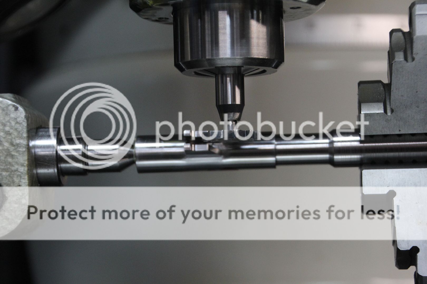

My machine operator time was many decades ago and measured in days. Still, I am captivated by the pictures of the work you do. It is light years beyond 'every day' machining and I really appreciate being able to 'work' vicariously through your photographs!

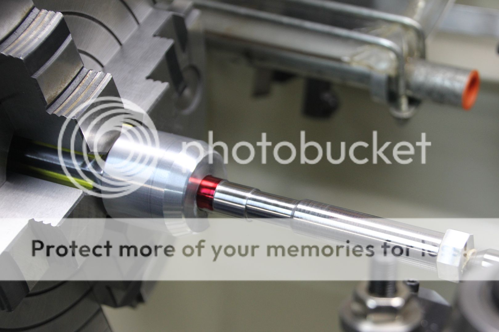

Would that grease there in the third picture make a good gun lube?  Smile
Posts : 1404
Re: 1911/45 wadcutter 1 X14 twist Douglas being born..
Post by Jerry Keefer on Sun Feb 21, 2016 11:44 am
Jack H wrote:Would that grease there in the third picture make a good gun lube?  Smile
Jack, that is old, as in very old,  Lubri Plate that I have had since my military machine gun days of the early 1960s...Smile

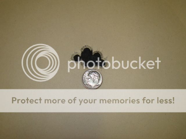

Jerry, what bullets and FPS do you predict will work best with the 1:14 twist?
Posts : 1989
Location : Haymarket, VA
Post by Jerry Keefer on Sun Feb 21, 2016 4:54 pm
Christopher Miceli wrote:Jerry, what bullets and FPS do you predict will work best with the 1:14 twist?
I am  thinking that,  lead projectiles will benefit from the enhanced land / groove ratio while traveling in the 690/700 fps range for long line. Although, in the past I had a 14 twist barrel from the same blank, that shot amazing groups with Zero 185 JHP at around 750 fps from the barrel tester. I was told that Zero had a copy of the target on display at Perry that year..

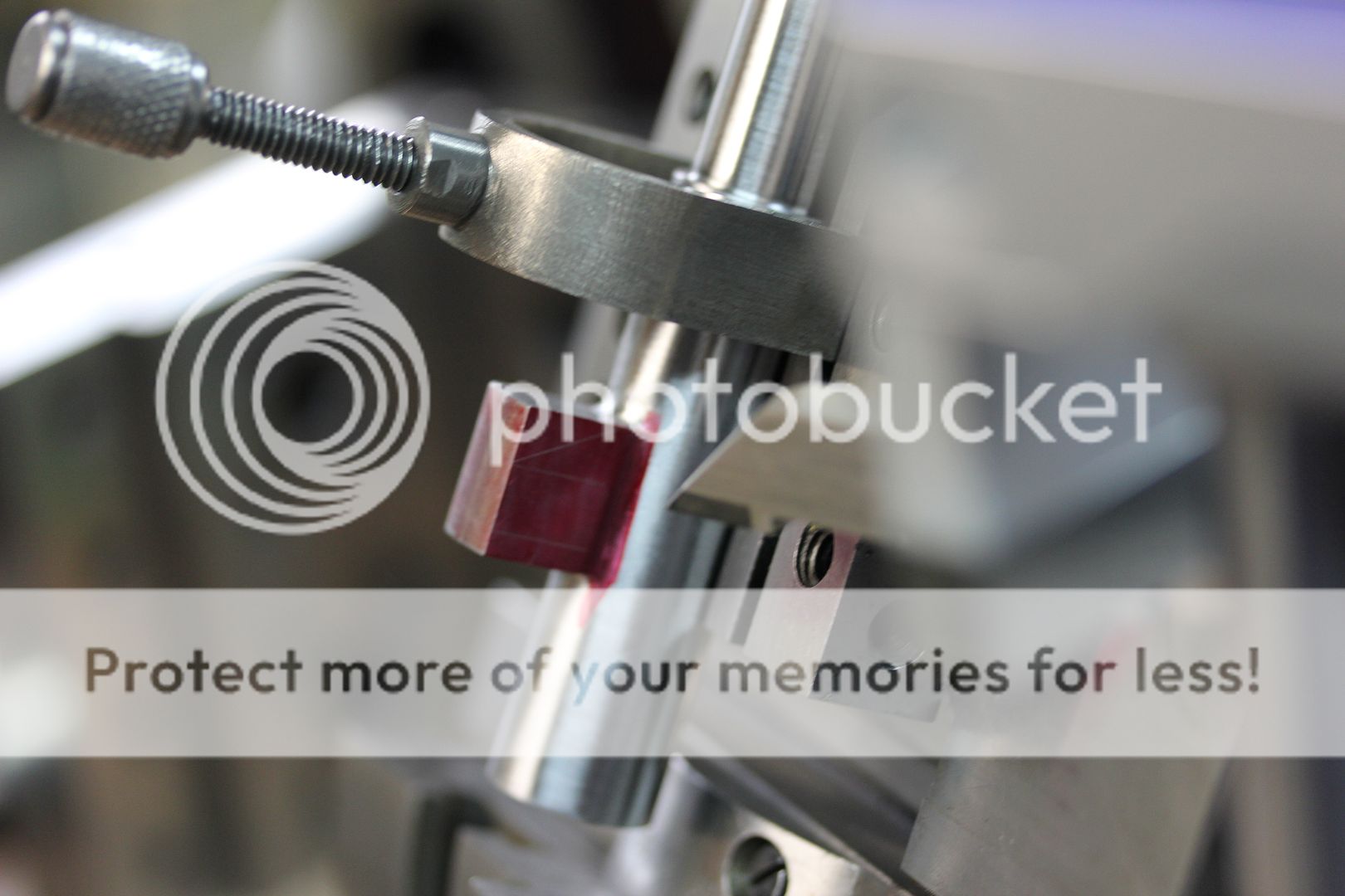

Lower lug day..
Jerry do you have a photo you can post of that target?  I've heard rumors of this white unicorn...lol
Posts : 655
Post by Jerry Keefer on Tue Feb 23, 2016 10:56 pm
JayhawkNavy02 wrote:
Jerry Keefer wrote: Although, in the past I had a 14 twist barrel from the same blank, that shot amazing groups with Zero 185 JHP at around 750 fps from the barrel tester. I was told that Zero had a copy of the target on display at Perry that year..
There are 15 shots in that cluster.. It measures .835 approx.  Zero 185 JHP with 4.8 700X mixed random  brass...
 1X14 twist Douglas.
Post by Chris Miceli on Tue Feb 23, 2016 10:57 pm
From barrel tester Jerry?
Posts : 1989
Post by Jerry Keefer on Tue Feb 23, 2016 11:11 pm
Christopher Miceli wrote:From barrel tester Jerry?
Yes... Never checked it in  a gun..

Dialed in the upper and lower lug today.. I'll probably shorten the length to two lug width.. Still thinkin..
 1X14 twist Douglas.
Holy cow! Impressive.  Without the picture I am not sure if I would have believed it was possible.  Certainly was not shooting MY reloads. :-)
Chip
ChipEck
Posts : 169
Join date : 2015-11-15
Location : Wisconsin
Post by Jerry Keefer on Wed Feb 24, 2016 10:58 pm
Zero told me their ammo test barrels produce very similar or slightly better groups..
My barrel tester is quite robust, so it gives a very good representation of the capability of the barrel.

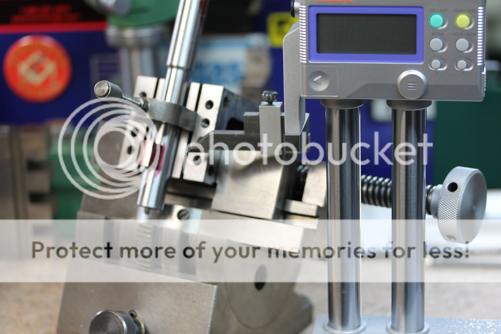

Post by Jerry Keefer on Sat Feb 27, 2016 12:37 am
Post by Jon Eulette on Sat Feb 27, 2016 12:51 am
Dang......integral cone! Yee haw!
Posts : 1918
Post by Jerry Keefer on Sat Feb 27, 2016 1:01 am
Jon Eulette wrote:Dang......integral cone! Yee haw!
I am telling everyone it's a seamless fit..SmileSmile
