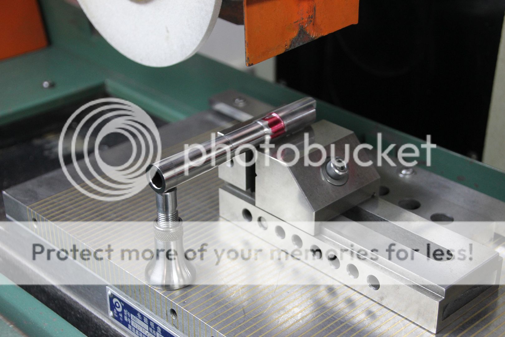

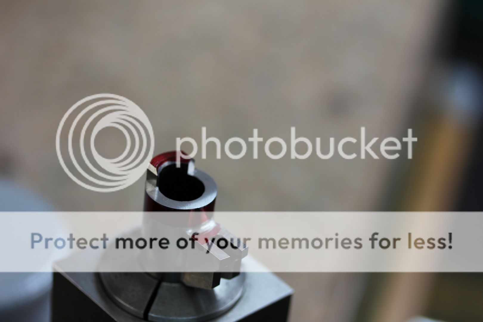

Working on the hood
Cutting a chamfer on the hood edges, prevents them from bottoming out in the slide and creating a false reading, which often results in a short hood..

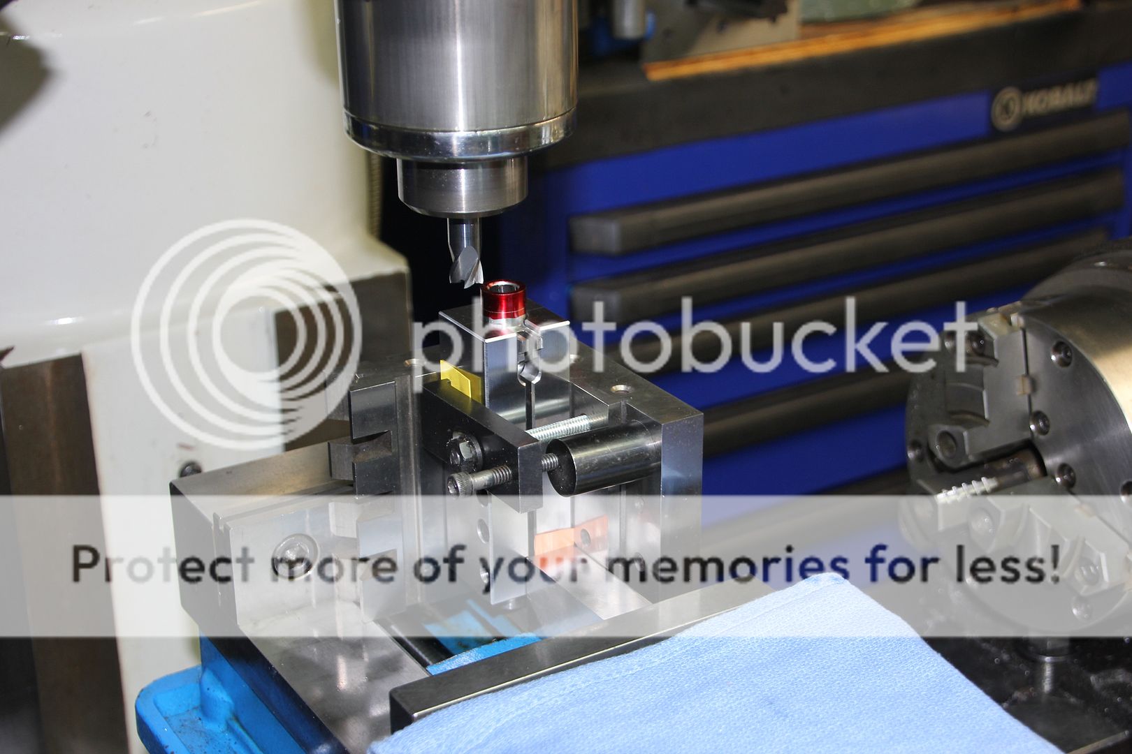

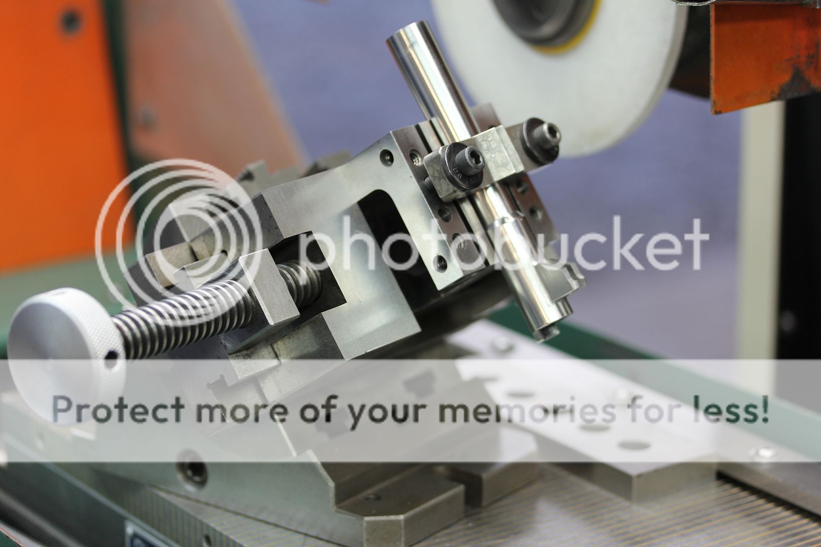

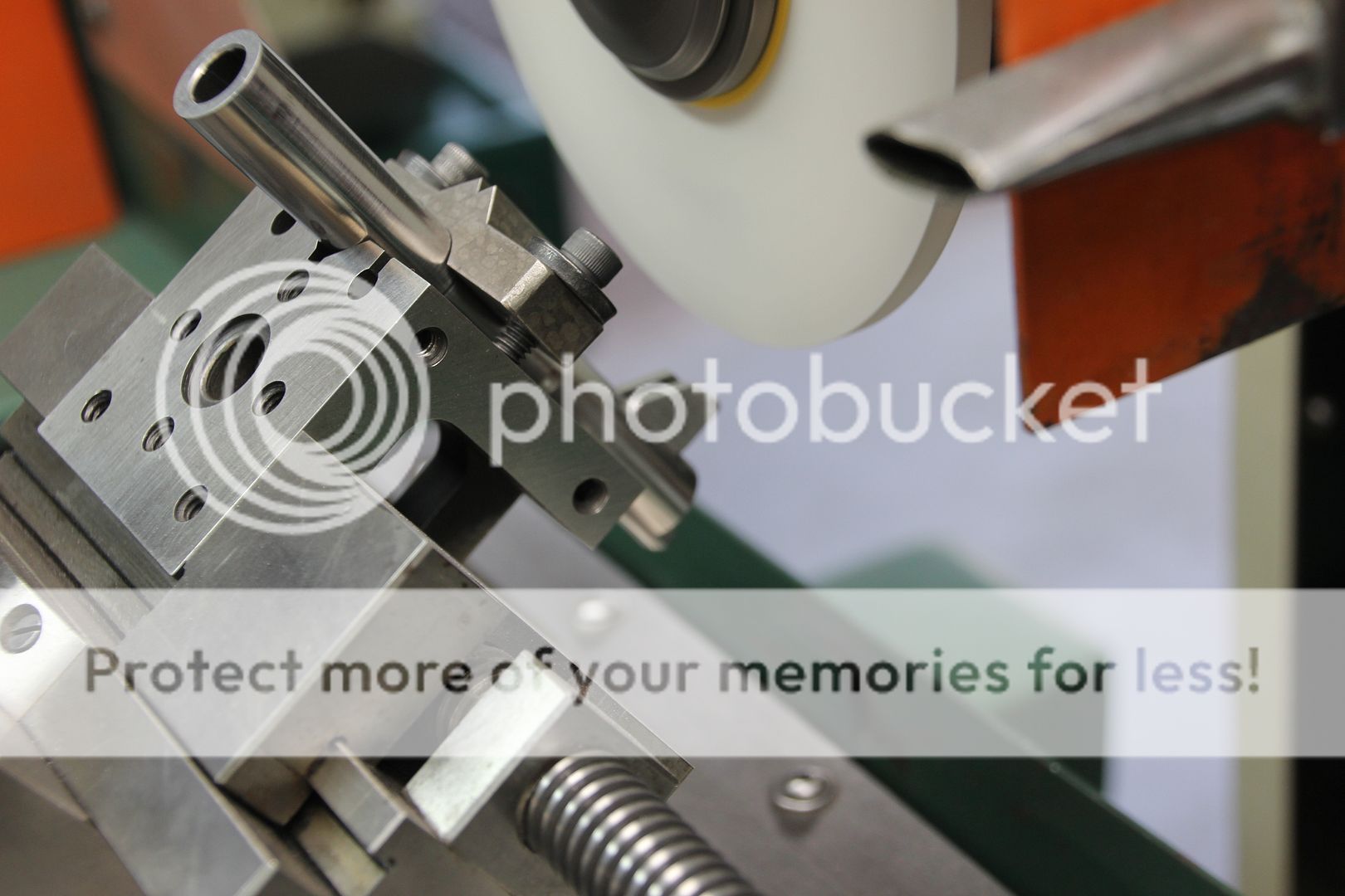

Took some time off from the barrels to get the IRS and SS regulations out of the way..still a few loose ends to finalize.. I dread it..
Profiling the front angle enough to get the lug cutter in.. Final cuts will be after the lower lug is fit.., and putting a clearance cut at 12 o clock in the upper  lug to prevent high centering..

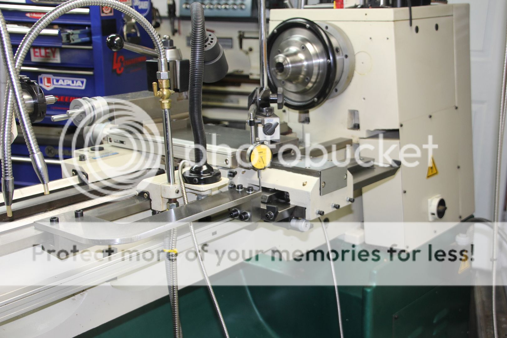

A  little equipment up grade with a new taper attachment to facilitate  those tapered cones...SmileSmile

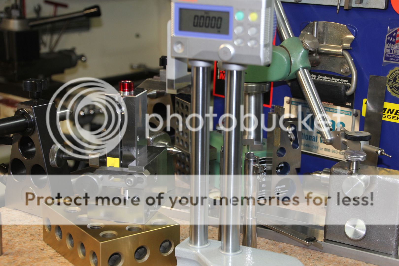

Here I am working on a prototype 1911 gunsmith tool.. truing two blocks of 4140 pre hardened before layout.. Jo Block quality.. another seamless job..Smile

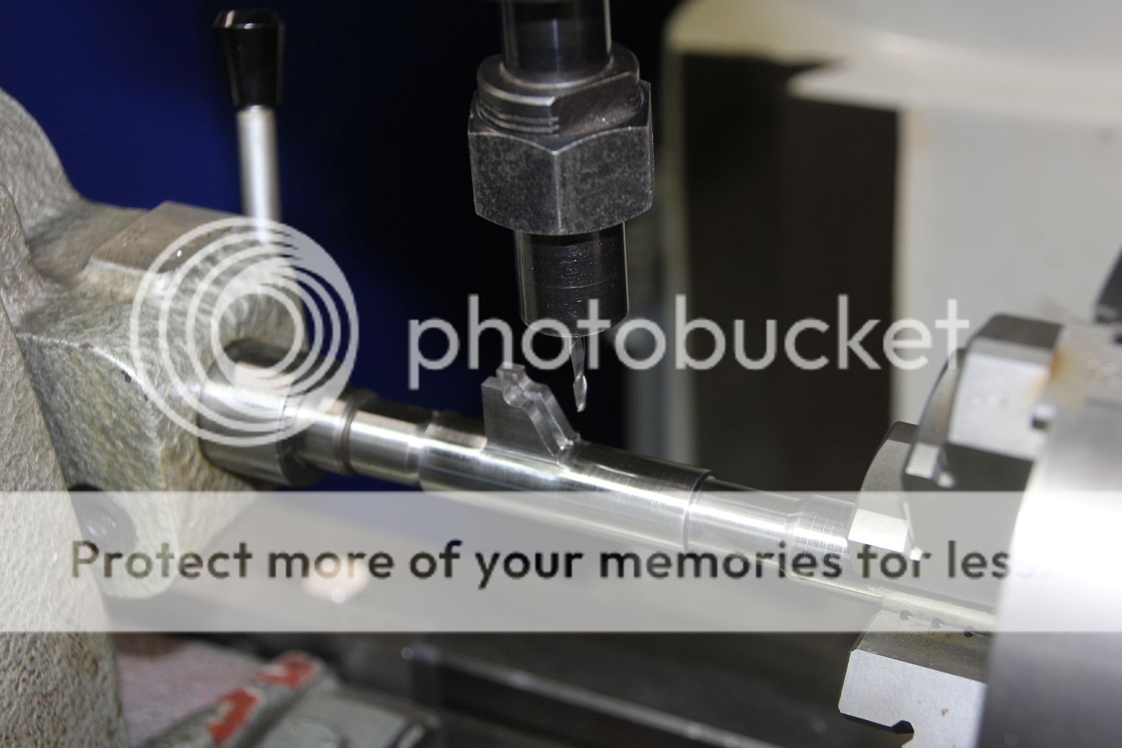

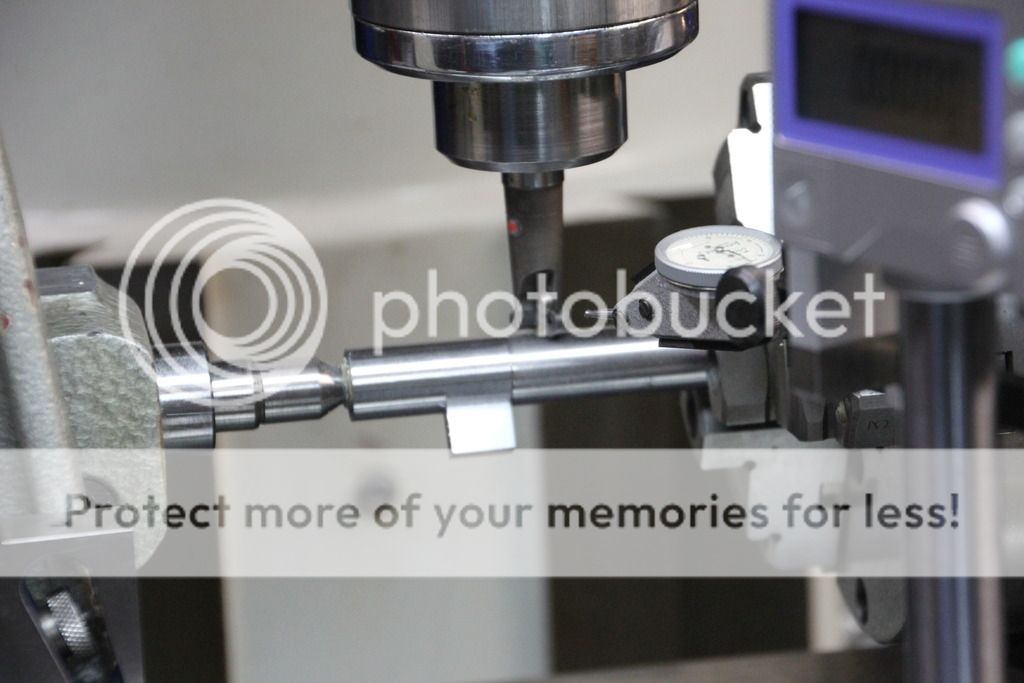

Perry is fast approaching.. The 14 twist, one  lug barrel barrel in the above thread, has many thousand thru it and is doing so well that I am anxiously working on this 12 twist.. Closing in on finish.. Here I centered the lower lug with the bore line and roughed out the link slot..

Post by SNaymola on 5/24/2016, 2:24 pm
Jerry Keefer wrote:Perry is fast approaching.. The 14 twist, one  lug barrel barrel in the above thread, has many thousand thru it and is doing so well that I am anxiously working on this 12 twist.. Closing in on finish.. Here I centered the lower lug with the bore line and roughed out the link slot..
Jerry, does the sharp step on the barrel lug where the slide stop pin rides over and rests, get cut out later, or is it part of the final design?
Stan
SNaymola
Posts : 38
Join date : 2013-11-25
Re: 1911/45 wadcutter 1 X14 twist Douglas being born..
Post by Jerry Keefer on 5/24/2016, 3:40 pm

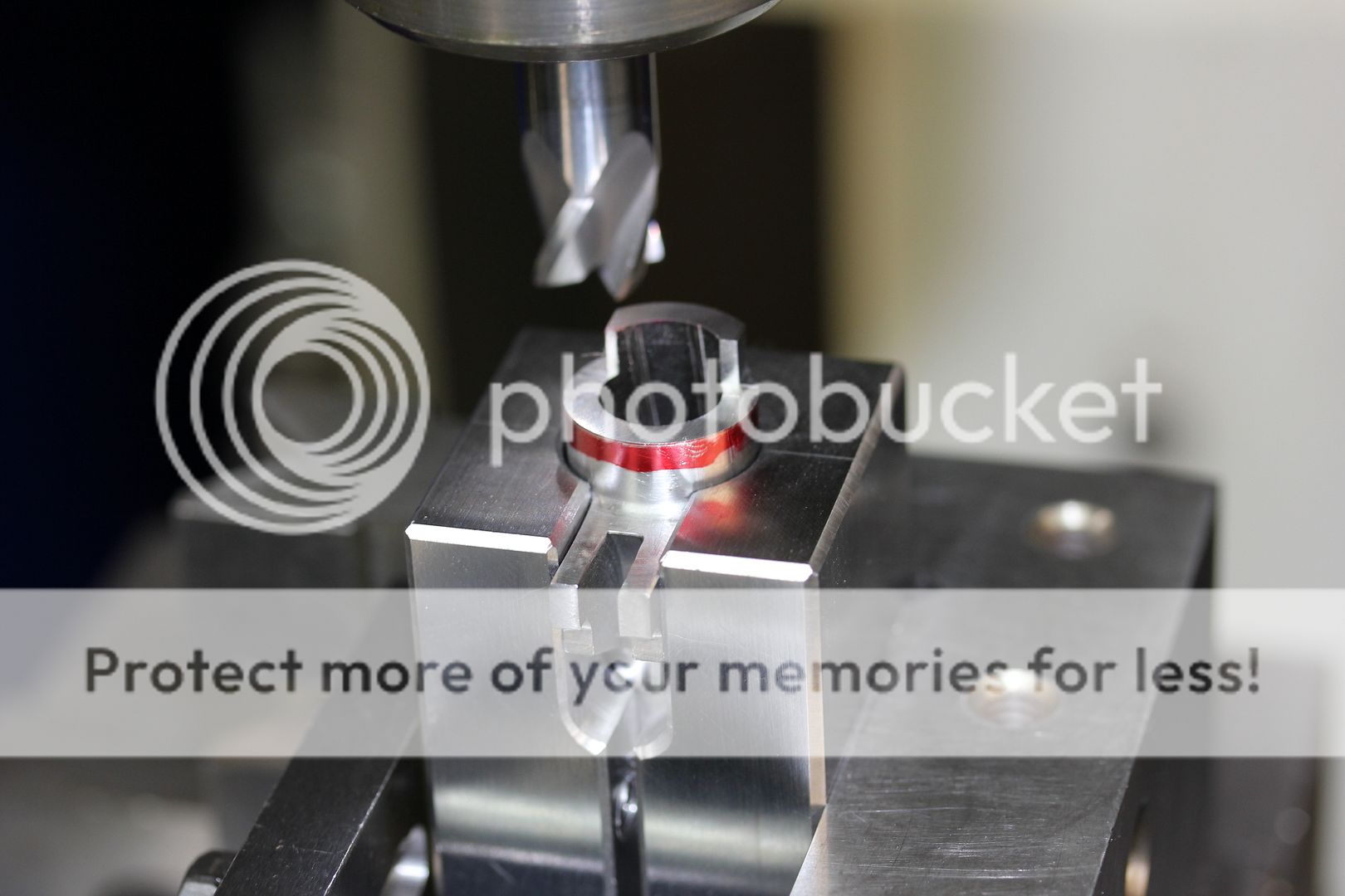

Yes, it is not any where near final fit.. I rough it out so I can get enough clearance to cut the link slot to depth.. Even then, that slot is tricky to get right..I ground a special cutter to get the depth,, and width.  The slot is .135
 I am roughing the slot with an endmill to take the load off the woodruff cutter and create chip clearance.

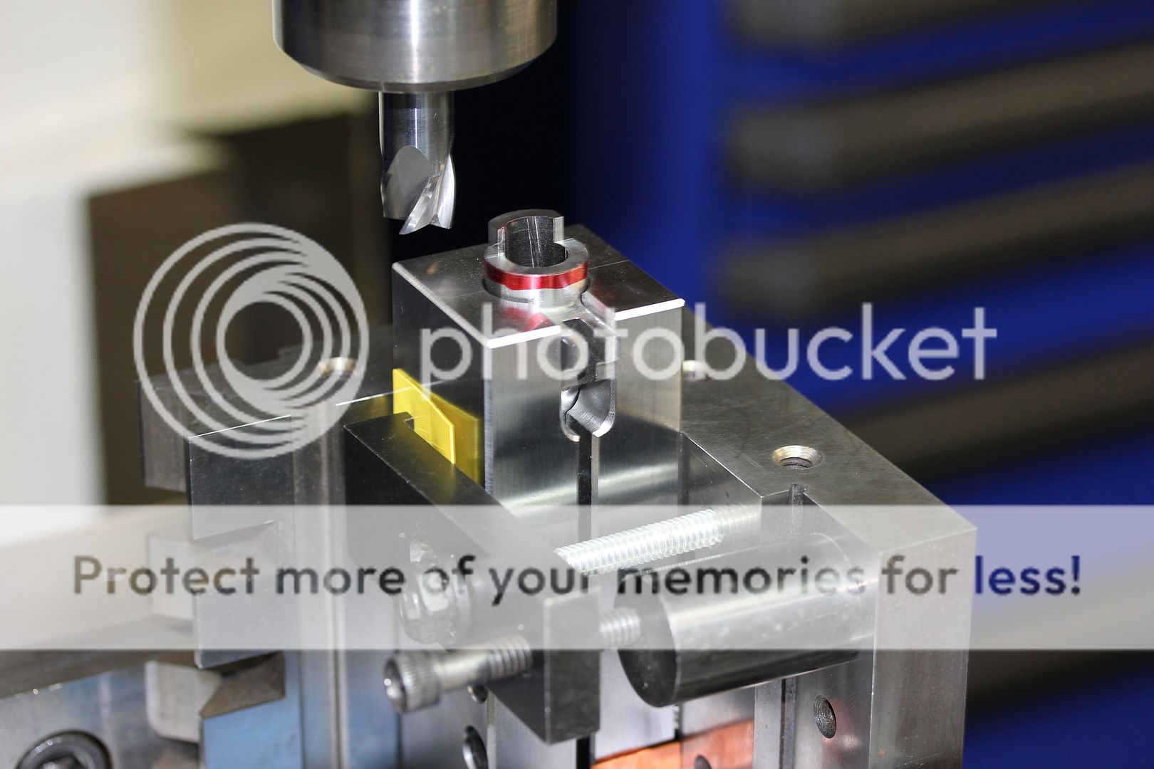

Post by Jerry Keefer on 6/13/2016, 3:59 pm

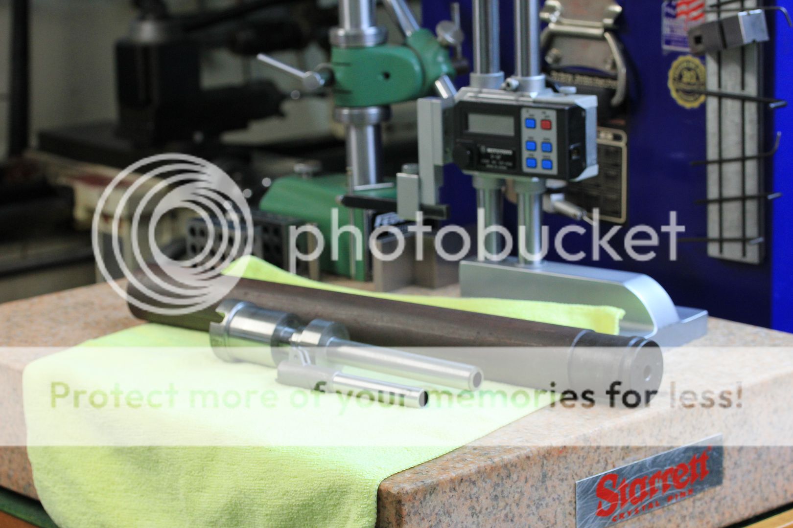

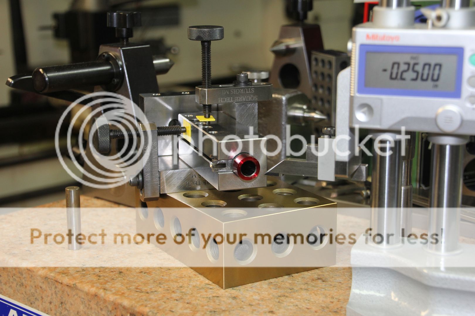

Decided to make a fixture to enhance finishing the barrels..[since I am no  longer buying barrels..Smile]  This is ground square and true in relation to the lower lugs.
I can now install the barrel. Layout the roughing cuts and move to the mill without losing a zero.. It will also aid greatly in chambering / crowning to align X-Z axis
This is a 12 twist I hope to finish for Perry..
