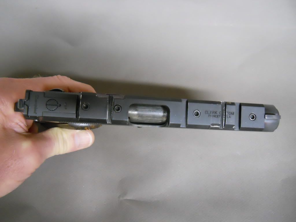

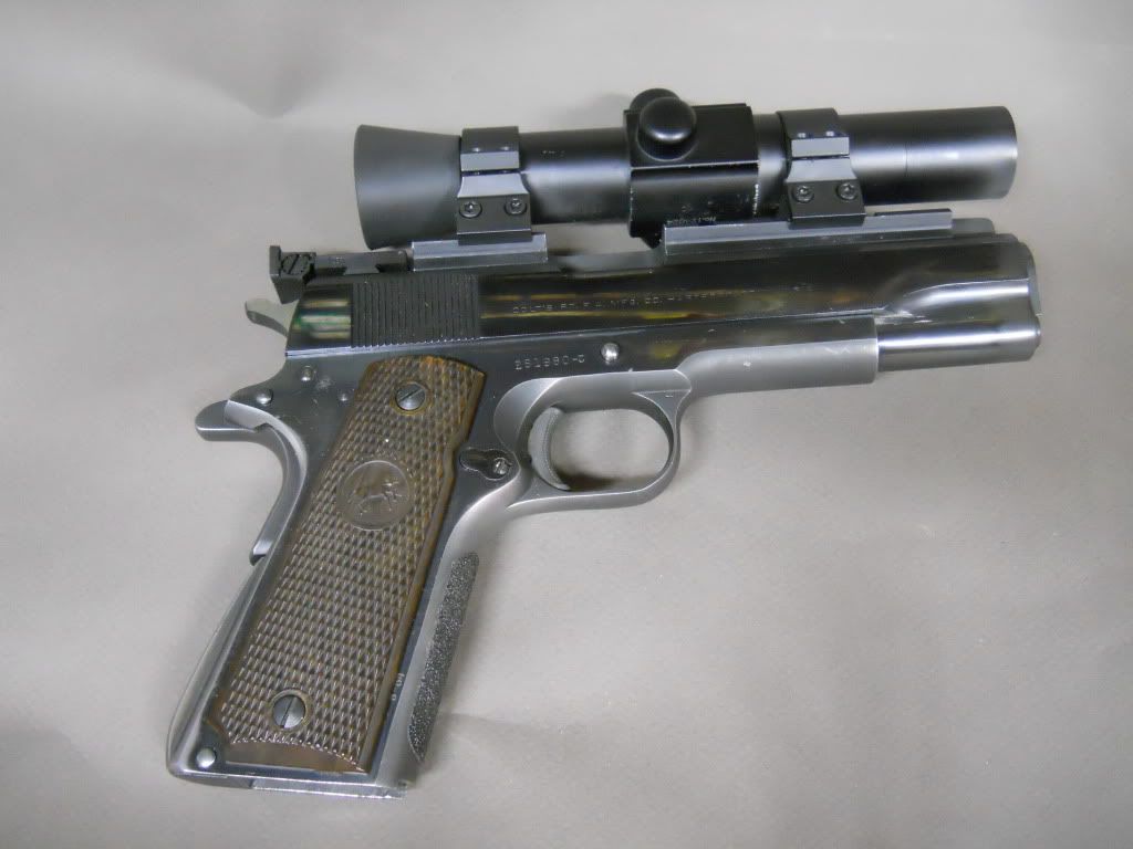

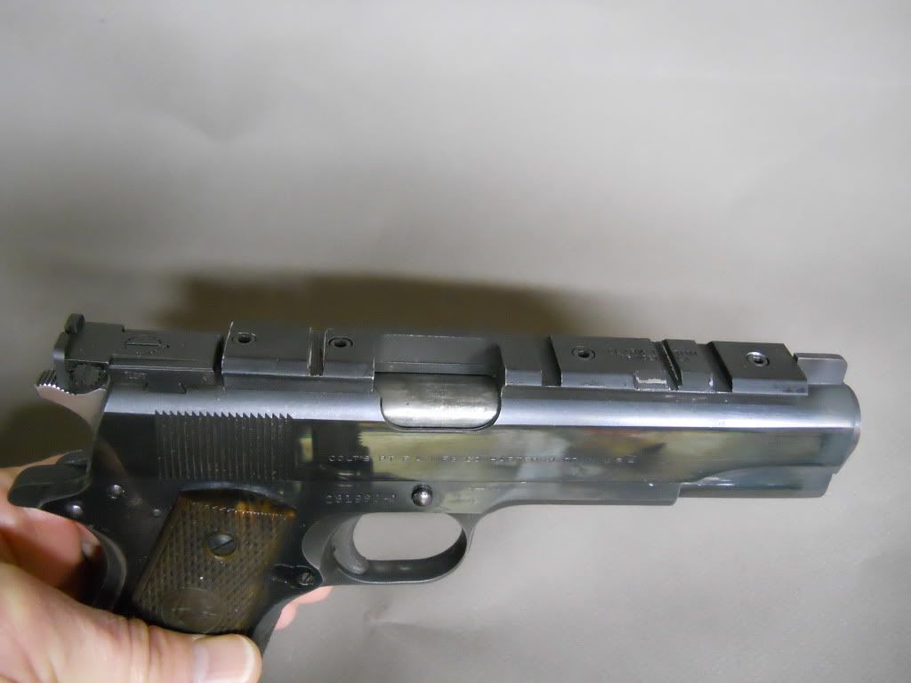

Post by charlie_seablom on Mon Dec 26, 2011 9:47 am
Here are some photos of mine:
Not real pretty but it works. The sights are slightly higher than the rail so you can use them with the rail in place. I wouldn't want to shoot a match that way though.
