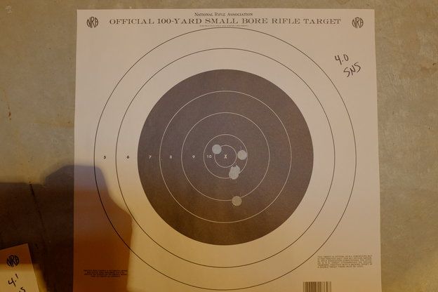

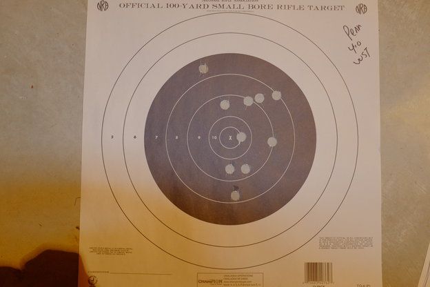

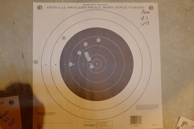

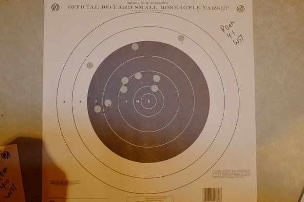

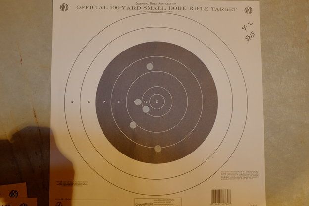

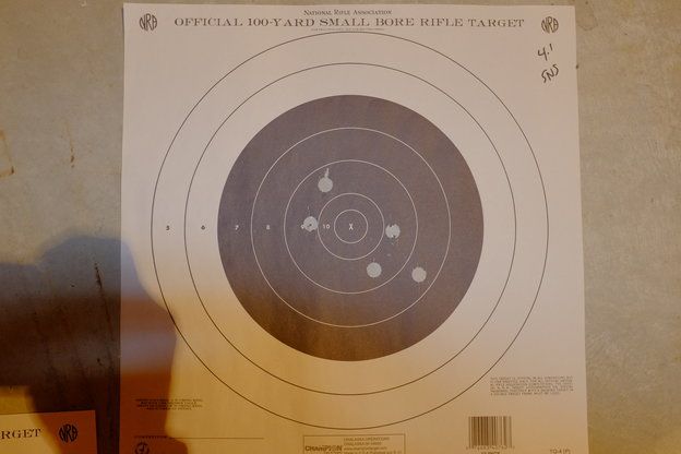

I finally got out and shot some test loads with my 5" STI Trojan with trigger job from Brazos and Match Dot on a slide rail.  I used WST powder on all loads and RCBS 3 die carbide set on the Penn Bullets and taper crimped to .970.  However, I used a Redding taper die to .970 on the SNS bullets as I just received it last night. I know the value NOW of a Ransom rest.  This was tiring.
IT SHOULD ALSO BE NOTED THAT I WEIGHED EACH PENN BULLET AND LOADED ONLY THOSE 203.5 +/-   .1 gr  BUT DID NOT WEIGH THE SNS AS THEY SEEMED ALL VERY CLOSE TO EACH OTHER IN WEIGHT.
Sorry, these were the only targets I had at the house today.
10 shots, 4.0 gr WST, Penn bullets 200 LSWC MG, RCBS 3 die set with taper crimp die.
10 shots, 4.1 gr WST, Penn bullets 200 LSWC MG, RCBS 3 die set with taper crimp die.
10 shots, 4.2 gr WST, Penn bullets 200 LSWC MG, RCBS 3 die set with taper crimp die.
5 shots, 4.0 gr WST, SNS Casting coated bullets 200 LSWC, RCBS 3 die set with REDDING taper crimp die as final set.
5 shots, 4.1 gr WST, SNS Casting coated bullets 200 LSWC, RCBS 3 die set with REDDING taper crimp die as final set.
5 shots, 4.2 gr WST, SNS Casting coated bullets 200 LSWC, RCBS 3 die set with REDDING taper crimp die as final set.
I also shot a 5 shot group each of 4.0, 4.1 and 4.2 with the Penn, but they largely reflected what the 10 shot strings did.  With the Penn the 4.2 load seems tightest.  I just got the Redding die last night so loaded the SNS with those loads specified and used that die.  That's why I'm saying I'm comparing apples to kumquats- I did NOT crimp the Penn bullets the same, I used the RCBS 3rd die.  Is it the bullet?  The taper crimp die?  Variance in shooting?  I'm just not sure.  I don't want to keep testing, I want to load some bullets and practice!  I can say the 4.0 is the easiest shooting load and at 50 yards that SNS, with the largest spread at 2.58" was the best test I had.  My quandary is that the 5 shots with the 4.0 WST and SNS bullet was a very small sample size.  My gut tells to me shoot some strings with the SNS alone.  They seem clean and with the WST it's a joy to shoot.  Wish our club had a ransom rest, would provide more insight, but any insight into what I'm doing wrong is appreciated.

I'd sure load up some more of the 4.0 SNS to give it a real try..

I think I'll do that for sure.  I'm not sure if it's the bullet or crimp or both.  But if the SNS seems to be the ticket I have 1,000 of them on hand and will use my supply of Penn bullets for practice.  I re-checked, my Penn are target grade, not match grade.  But in any event they vary wildly in weight from 199.5 or so to 206.  Out of about 500 I weighed while watching TV, I got about 75 weighing 203.5.  The rest seemed to be clustered around 202 and 204.  I have no desire to sit and weigh bullets, that's for sure.
