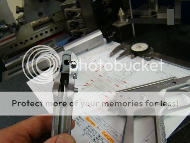

At one time, Joe Cominolli sold a blue print system with just a slight variation, to avoid conflict with the Kreiger patent.
I don't know if he still offers it or not.. The tooling, fixtures, and instrumentation to cut and measure is rather costly...Like I said before, there is zero room for error..A three axis  DRO is a must in my opinion..
www.cominolli.com

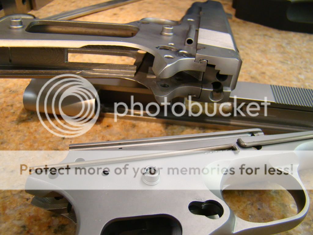

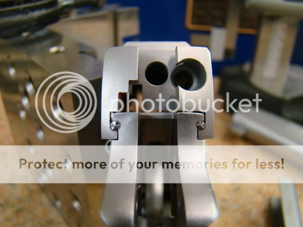

Solid, rigid fixtures to hold the frame and slide and cut both planes in one set up..  Must be capable of being zeroed on all axis.. Dedicated carbide cutters.. to true the flats and a radius cutter to cut the grooves. Woodruff key cutters will not work.. .075  rod to cut into rail  length..a fixture to create the 90° bend in one end..Good instrumentation..dial indicators/center finders, Z axis tool setters,  etc.. As I mentioned.. A three axis DRO is essential in my opinion.  That alone is $3000.  The prints,  if still available were $1000. 10 years ago..And, we haven't bought the rails, cutters or instruments yet..
You must create a true plane to work from.. I always use bottom rail contact.. Because that's how I think it should be..Some have used top rail contact plane, but I avoid that.. Working on newer and quality parts, enabled excellent results.

I had a nice conversation with Joe, who has given this up. (though there may be someone else doing it he is going to hook me up with)
Any chance you would share a better picture of that drawing?
