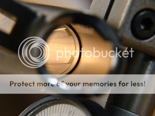

I am a proponent  of free bore in target pistols..This is an example of my favorite reamer.. Touching the lands/rifling is for bolt action rifles.. and even then, it's questionable.. We had a recent discussion on recoil.. Freebore, minimum chamber diameter and minimum head space reduces / eliminates the initial pressure spike,  because the projectile begins to move without resistance and the case seizes to the chamber wall much sooner in the ignition event, ending bolt thrust for that pressure period...
Last edited by Jerry Keefer on Wed May 04, 2016 1:30 pm; edited 1 time in total (Reason for editing : spelling)
Re: COAL for Zero 200 grain LSWC
Post by Rob Kovach on Wed May 04, 2016 1:14 pm
^^^SOOOO NICE^^^^^
