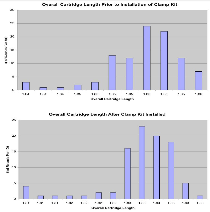

I am not one of the Masters or High Masters that carykiteboarder is referring to, but I have an opinion none the less.
If you go with the Dillon, I highly recommend the following accessories from Unique Tek.
   * CNC Machined toolhead with toolhead clamp kit installed
   * Micrometer powder bar
   * Precision Powder Baffle
   * Bin-Dam for the cartridge collection bin
p.s. I do NOT find the Arredondo powder drop bar to be more accurate than the Dillon extra small powder bar
I also like the toolhead light kit from Inline Fabrication.
I like the strong mount, roller handle and bullet tray from Dillon. Brian Enos is a reseller for Dillon Precision and you may find a package deal from his web site.
I prefer Redding dies over the Dillon dies.  I especially like their competition pro micro-adjustable bullet seating and crimping dies.
If there is a NRA Metallic Reloading class in your area, I recommend taking it if you have never reloaded before.

On my second trip to the AMU we sat down the head loading shop bubba, awesome guy and I would add this based on his expertise (not my own):
   * CNC Machined toolhead with toolhead clamp kit installed - worse than OEM, AMU will not use them.
   * Micrometer powder bar - faster but no more accuracy than OEM, AMU does not use them
   * Precision Powder Baffle - works as advertised, many versions, AMU weighs all charges, but for home use, shop guys said they're great.
https://www.amazon.com/Prairie-Dog-6-102-Perfect-Powder/dp/B00MIVA7IO
I saw only one set of Dillon dies in the AMU shop, the rest were almost entirely Redding with a few cats/dogs.  Someday when I hit the lottery I'll upgrade (rifle first)
Better IMO than than the strong mount is the UltraMount from Inline Fabrication,  I wish I would have bought that instead.

Is the AMU having an issue with the CNC Machined toolhead, or the clamping part or both?  If it is the clamping part, I guess I am going to disagree with AMU.  The OEM toolhead on the Dillon moves are you work the press.  Having used (and still use on occasion) a single stage press, I am used to having dies rock solid in the press.  When I switched to the clamped toolhead, my OAL and crimps became more consistent.  (You do have to follow the instructions that come with the clamping kit.)  If the concern is the CNC Machined toolhead, UniqueTek sells a clamping kit for the OEM.
The advantage of the micrometer powder bar comes in when you change charges.  Whenever you find the correct charge, write the micrometer number down.  When you need to return to that charge, set the micrometer to that number (and then check your charge with an accurate scale before reloading).

Can't argue with an AMU reloader...
I would be curious to know what is worse than OEM with a clamped toolhead.  I own the clamped tool head because it reduces bullet seating/OAL variation. (Zero .45 185gr JHP & Hornady XTP .32 60gr JHP) For .45ACP, slight variation in bullet seating depth/OAL due to tool head vertical slack is probably insignificant in the real world. For the little .32ACP rounds, the difference might be real. Obviously, the AMU guy does not care about .32ACP. Never-the-less, although it would not surprise me if the clamped tool head was no better than OEM, it's hard to understand how it could be worse.
Perhaps horizontal tool head slack improves some other element of the reloading. Sizing, flare, powder drop, crimp?  Also, if they weigh every charge, it would be interesting to see how that works on a progressive press.
I REPEAT... I am not disputing a guy from the AMU.  Neither am I asserting that any particular press is better than another.  My original point was that I personally tried a (red) lesser press and ended up with a (blue) better press and wish I'd skipped the first purchase.
As always, if anything I write is contradicted by a High Master, ignore me.  The High Master is right.  (An AMU reloader is a High Master Reloader.)
carykiteboarder

carykiteboarder wrote:Can't argue with an AMU reloader...  I REPEAT... I am not disputing a guy from the AMU.  Neither am I asserting that any particular press is better than another.  My original point was that I personally tried a (red) lesser press and ended up with a (blue) better press and wish I'd skipped the first purchase.  As always, if anything I write is contradicted by a High Master, ignore me.  The High Master is right.  (An AMU reloader is a High Master Reloader.)
They found the 550 to be slightly superior to the 650 in production and the 1050 to be the best of the Dillons.   The 650 had the most deviation, but one reloader has a 550 at home (pistol) and the other a 650 (rifle) for personal use, so both must be okay Wink.   Pistol supervisor (High Master) and the rifle reloader (high master/olympic medalist) seemed legit Wink. We learned a lot, kept our mouths shut and listened.   Great lesson in components, equipment and tools.   They had RCBS Rock Chucker single stages, old, not the China stuff, and quite a few so it was an assembly line, a 650, 550 and a couple 1050s.
joy2shoot wrote:Is the AMU having an issue with the CNC Machined toolhead, or the clamping part or both?  If it is the clamping part, I guess I am going to disagree with AMU.  The OEM toolhead on the Dillon moves are you work the press.  Having used (and still use on occasion) a single stage press, I am used to having dies rock solid in the press.  When I switched to the clamped toolhead, my OAL and crimps became more consitent
They found no difference in performance with the CNC machines vs Dillon toolhead, the problem is with the clamp.   The explanation to us was that the 650/550 have quite a bit of movement,  Allowing the toolhead to "float" permits alignment.  When you lock the tool head in place you prevent that and lose consistency.   A single stage doesn't suffer from the same movement.  By locking the toolhead you are preventing the press from "settling" as they explained it.  Given they're setup and experience, that was good enough for me.
From the photo, which is from a review, which will hopefully upload soon, if not, I'll get it uploaded at home on my PC vice phone.  Before the clamp kit the deviation in OAL is +/- .01, but after the kit is installed the deviation is +/- .02. Without the clamp, 12 of 100 are outside 1.85 OAL, but again, within +/- .01 OAL, after installation there are still 12 of 100 outside 1.85 OAL, but with the deviation -.02.
The shop guys, one of them an Olympic shooter/medalist are supporting other National and Olympic shooters, both rifle/pistol, with range facilities that none of us have access to and talent that is rare to execute.   If there was advantage they would take it.

Well, I do agree that the tool head clamp is not needed on the 650.  With the tolerances of the shell plate, dies and total head assembly, fixing the head in position will generally produces some other issues worse than just letting the whole assembly find its center.  A smoothly working 650 will produce excellent and extremely consistent pistol ammunition.
Biggest issue here is that we can NEVER get a consistent OAL measurement.  Because the nose distance of every bullet will be slightly different with respect to a point on ogive of a jacketed bullet or the shoulder of the SWC.  Sometimes not by much, sometimes more than you think. So some of what we are measuring is manufacturing tolerances.
So the best we can do, particularly with a progressive press,  is get a jacketed bullet seater that contacts the bullet on a consistent point of the ogive or the LSWC shoulder, (not the nose of either).  If your jacketed bullet seater is using the nose, you might want to relieve it there and see if that helps your measurement or groups.
While I got the same OAL differences with jacketed 185's (Nosler, Zero, etc.) with either seating method.  I got smaller groups with the ogive contact seater.  Basically, I'm looking for a consistent distance from the base of the bullet to where it will first contact the lands every time.  (The nose distance does not make any difference.)
Additionally with lead bullets, I got better results by seating the bullets in 2 steps (the 650 will allow this).  A partial seat on station 3 and final seating on station 4 (using the above mention shoulder seating stem for the final seat).
I think Dillon dies are great and that's all I use in my 650.  And I use "O" rings under each die in the tool head (except sizing).  The O rings keep the die pushed "up" in the threads, the same direction it would go when contacting the shells.  I also check and deburr the inside of the powder measure assembly, lightly polish the detent holes on the bottom of the shell plate for smoother operation.  You should also make sure the wave washer on the powder measure bolt is providing enough friction and mark the location on the bolt and assembly so you can see any movement.

Thanks!  I learned something new again.  I checked and the bullet seating dies I use for JHP do indeed contact the bullet about half way between the nose and the edge of the ogive.  That explains the (reasonably small) variations I was measuring in OAL.

25-20 from the article.  Never heard of it.  The important takeaway, for me, was that, yet again, the toolhead clamp/CNC combo is not required.
Dillon also states that it is not recommended as it hampers performance.
