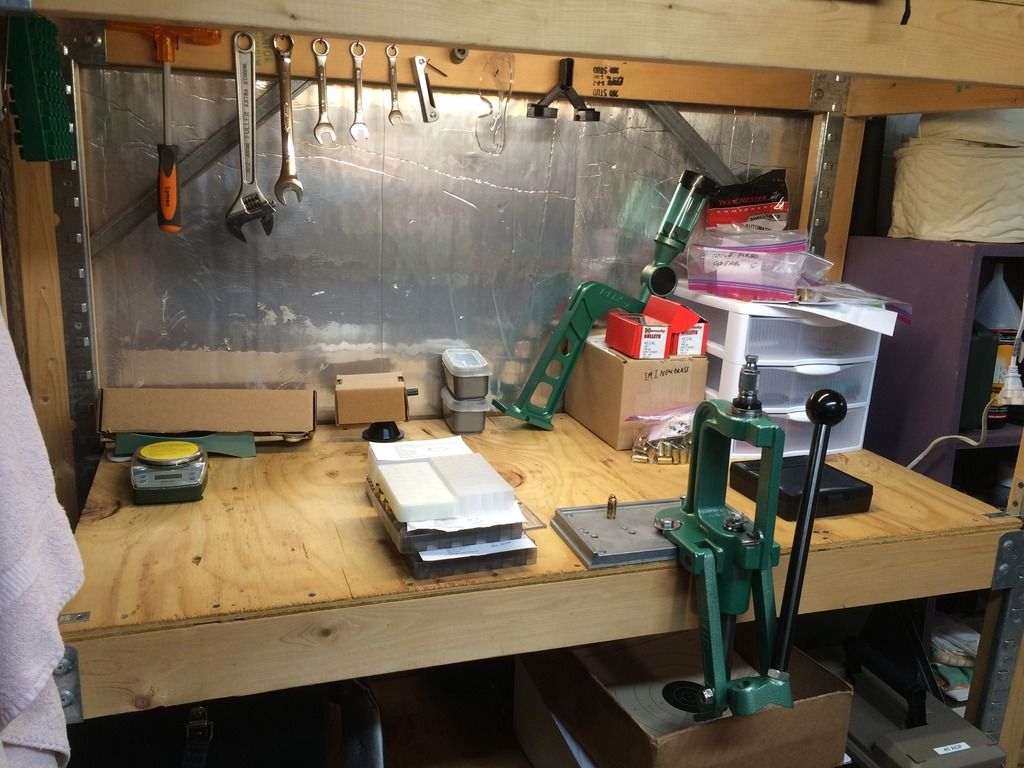

Well, I followed the prevailing advice, here is the standing reloading bench I just set up.  I sit all day, so I chose to make the press at standing height.  I still have a bit of organizing to do.  I love the Hornady quick change die set up.  the little gray tupperware kit hold the Lyman 4 die set with the quick change collars.

That's an RCBS press.  So how does it take the Hornady quick change setup?
Posts : 1199
Re: .45 off the shelf question
Post by Jack H on Tue Oct 25, 2016 1:07 am
There is a Hornady  screw in adaptor for the RCBS press with the big nut looking top.  You take the big nut out.  Older RCBS do not have the nut.
