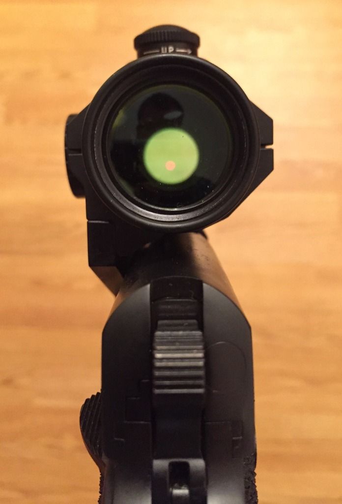

Post by JayhawkNavy02 on 5/29/2016, 8:54 pm
Jerry and Dave both had good words that I absorbed when I was ordering my wad gun.  So as a new shooter when it was time for a mount, I went with what both recommended.   The disclaimer, is that I normally shoot my ball gun for service competition so I'm ecstatic with the lower recoil of the wad gun in general, but if I could I would like even less.
Until I get a Master/High Master card and start making top notch 1911s I'm not going to tell anyone what works best, but a slide mount is easier to fit in your box...lol
Dot is off center so it looks lower than it really is.
