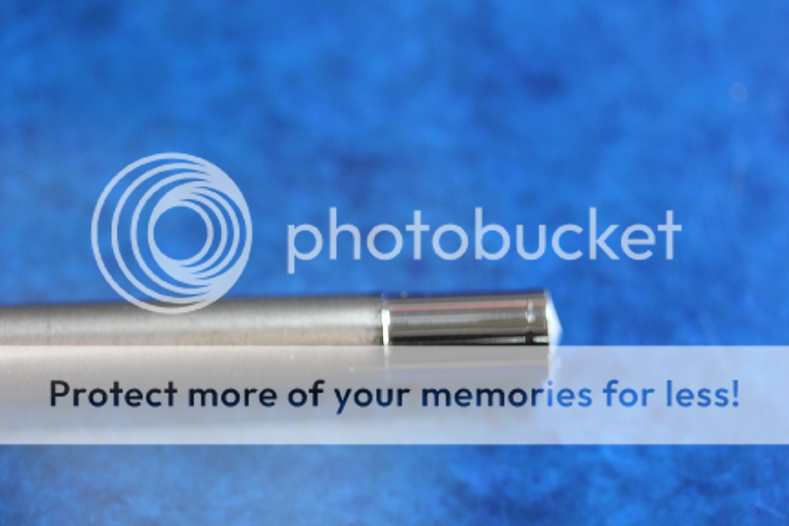

Post by Jerry Keefer on Sat Jun 11, 2016 11:02 am
A carbide extrusion punch...
You can see the relief and land that allows the brass to flow over the punch face and pull free when the punch is extracted..
Most punches are M-2 but we used many carbide punches..
