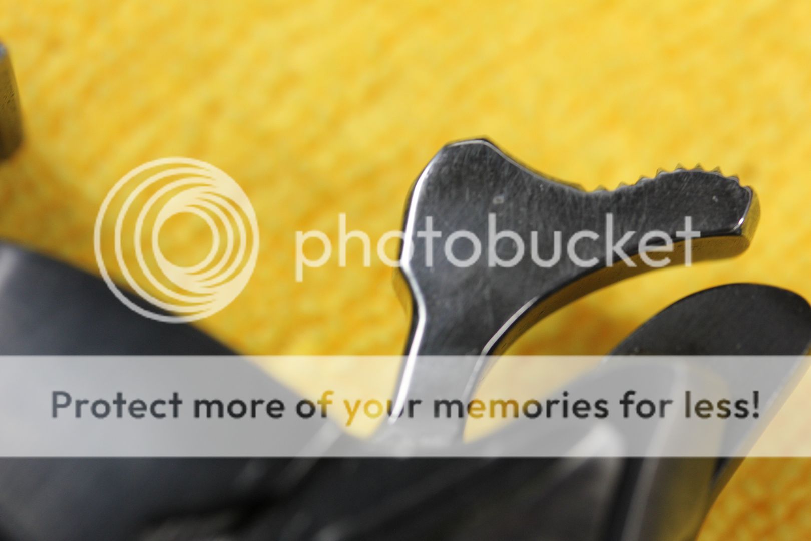

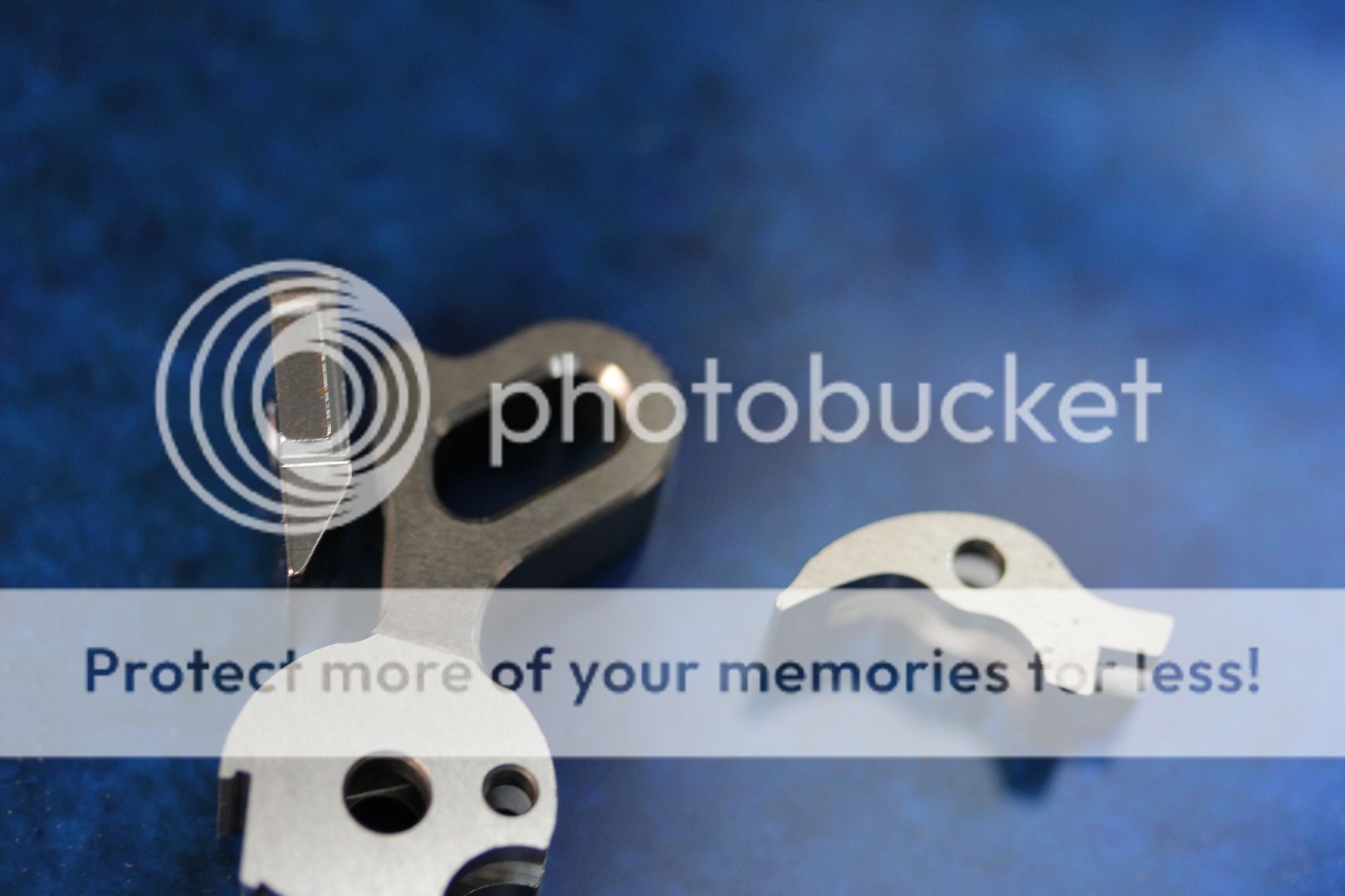

All my guns are on the way to Perry, but here's a pic or two that might illustrate the difference... It depends on what type gun.. Wadcutter or Ball gun..
I use Chuck Warner's TR system.. His  hammer is stout, relieved to match a steep angle on the firing pin stop.. I relieve the hammer even more.  I don't want any energy bled off cocking the mechanism..Hard ball is the complete opposite, were square bottom stops  and angle contoured hammers are more desirable..
The last picture is a light weight hammer, that is prone to breakage.. Too thin, after breaking several, I no longer employ this design..I have never broken one of Chuck's.. They are available thru Harrison Design..

Post by SmokinNJokin on 7/8/2016, 10:51 am
Jerry,
I really like that top hammer, looked around on Harrison Design's website and couldn't find it. What do they market it as? The 'extreme duty' hammer with TR sear did not appear to be relieved at all.
