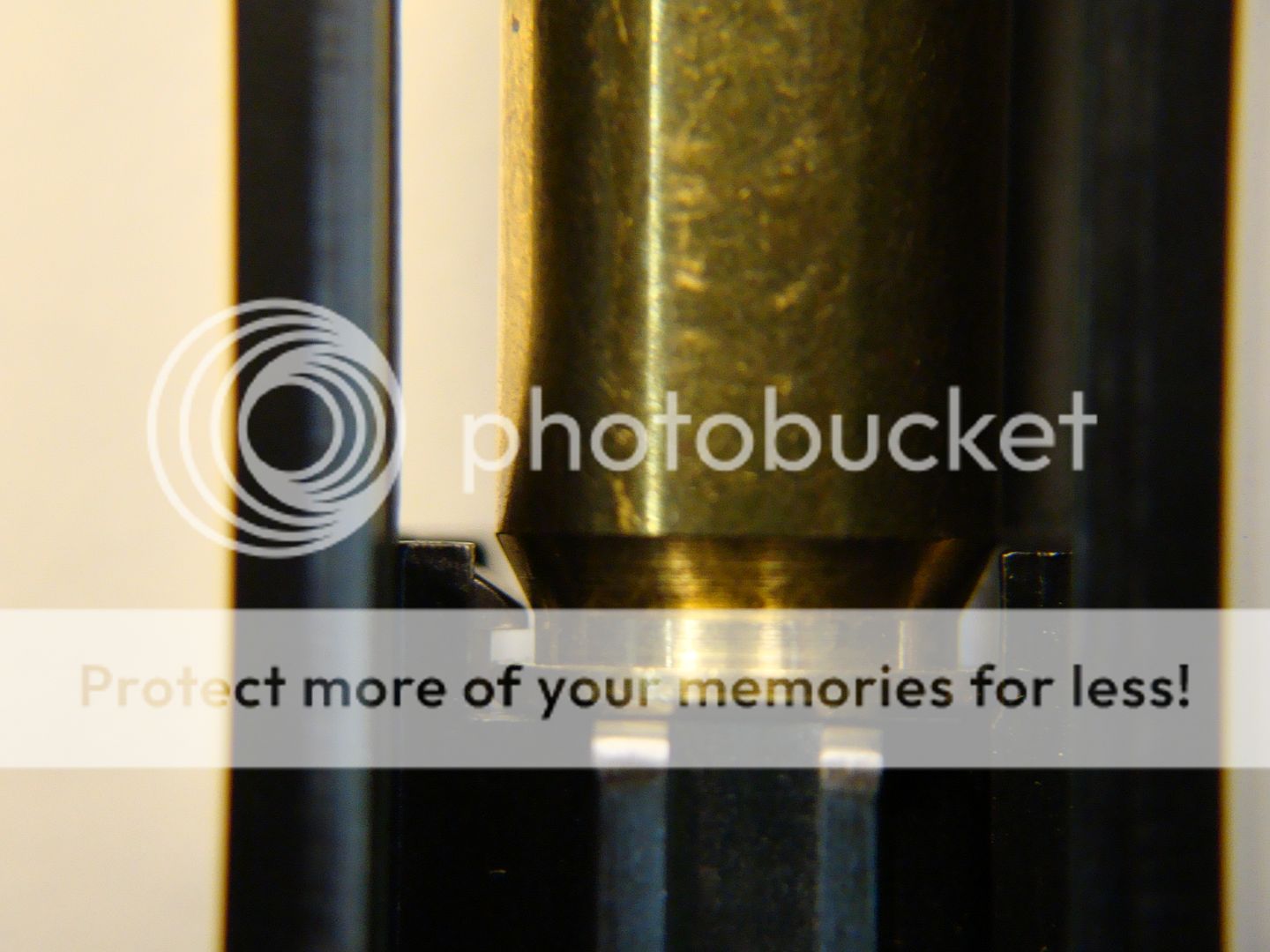

I am a big fan of EGW extractors. The main factor to longivity,  is proper fit.. The extractor is one of the most poorly fit parts on the 1911.. To get it right often takes silver soldering a shim  into the fring pin stop slot and moving the extractor to the rear.. The frist pic shows the average extractor fit.. The case rebate angle is resting on the nose of the extractor.. With every shot the chamber pressure forces the case against the extractor nose... How many impulses until it breaks..????  The second picture the extractor has been welded and moved to fit correctly... This also has an effect on accuracy.. Do we want the extractor forcing the case to one side..?? I think not.

Thank you Jerry looks like this is not something that is necessarily a drop in part.  Now I just need to see if a gunsmith I know is available.
