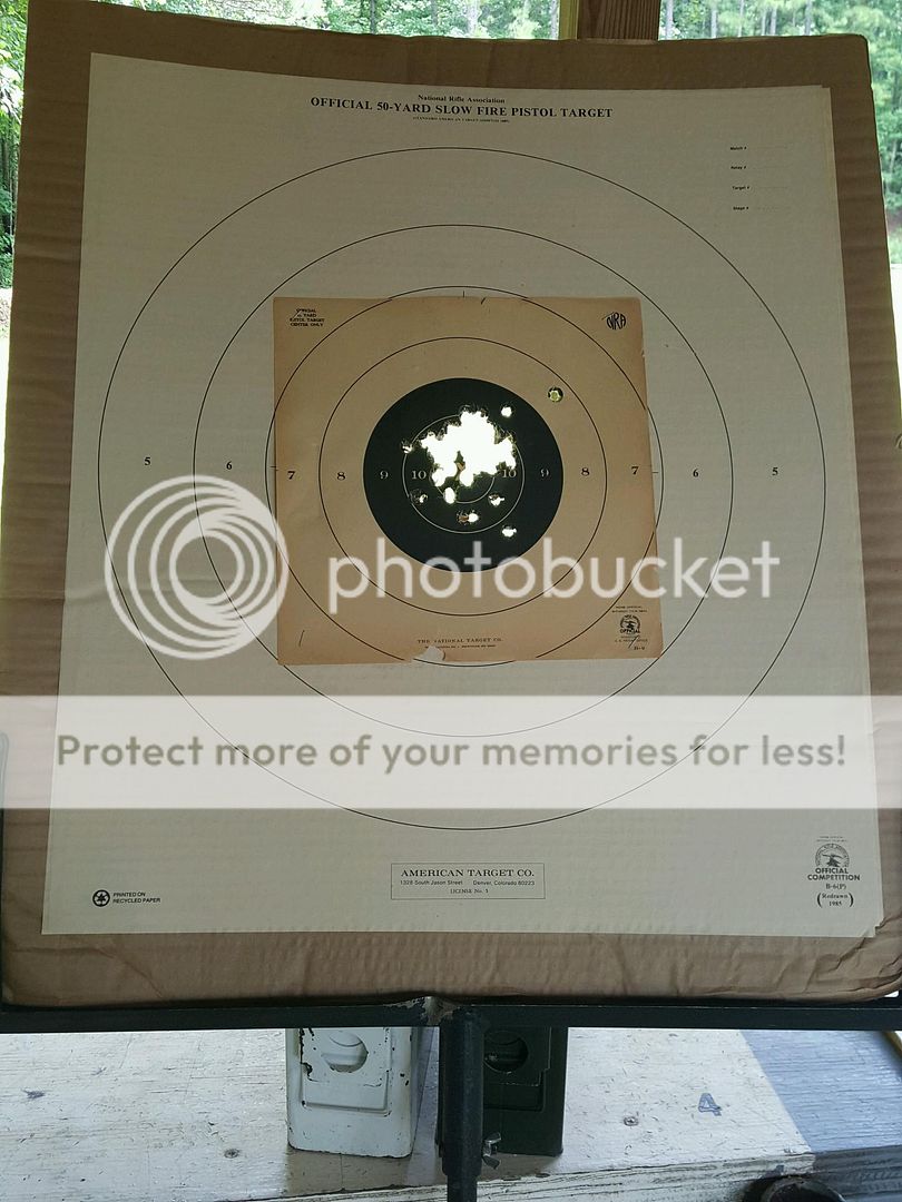

Post by Jerry Keefer on Fri Aug 05, 2016 1:08 pm
SmokinNJokin wrote:Jerry has mentioned running loads as light as 3g bullseye, and also that he prefers Vectan
A slight mis print...
2.9 to be exact..
This target was shot yesterday..12 strings of rapid fire with 2.9 gr. and 185 gr. lead.. on a turning system.. The shooter must be able to "shoot the turn.." and why I am so adamantly against stationary electronic targets..
2gr. for the 52/38 at short line...
52 / 38 long line...not yesterday..just sayin..
