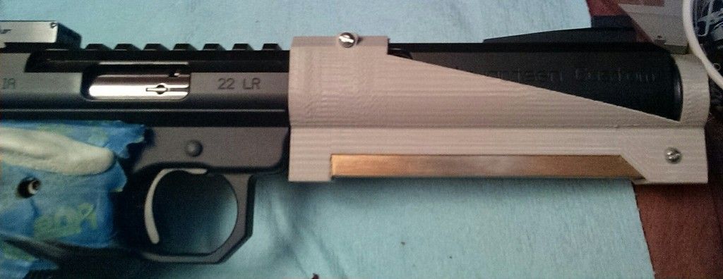

Post by Saladman on Wed Aug 17, 2016 9:28 pm
For cleaning or rather prevention of debris buildup on compensators (or anything really) you could purchase some pure silicone oil and then bake it on as a sort of glaze.  This method has had excellent results for keeping dirty .22LR silencers clean, and also made cleaning them super easy.  I don't have any thread links right now but you can probably google search silicone silencer or something like that for a more concrete method explanation.
As far as the Volquartsen LLV I purchased one last summer and I liked their setup so much that I purchased their bolt and frame to complete the gun.  As far as weight I decided to add a 3D printed barrel weight mount and used a 5 inch section of brass rod to add a few ounces.  It now weights 43 ounces and shoots like a dream.

Post by Saladman on Wed Aug 17, 2016 11:03 pm
No but I'll go take some and update this post soon.  Laughing
The grips are very much a work in progress, and I'm not sure how to make them as suitable as I would want but they work as of now.  They are made from two sets of two part epoxy putty I bought at the hardware store and applied while holding my hand there for a while until it sets.  I think when I get the final product done, as a like super grippy grips, I will add some more epoxy to the surface and then some silicon carbide grit for ultra handpain grippiness. The stock rubber grips aren't something I want to permanently modify so it's currently sitting like this until I figure out what to do.  I may wind up buying some basic wood grips for it and building off of it with more wood putty.  Shocked
Anyway, the weight holder I made using my 3D printer (Rigdbot kickstarter).  It's not particularly difficult to get something to print and look good, rather it is difficult to get the sizing correct as the printed object tends to be smaller as a final product than it is when selected in the printing software.  I think this part was printed 105% over-size but I'd have to check its G-Code in Cura and I haven't made anything else that required such precise fitment.  The holder didn't use to wrap around the barrel but that model felt floppy and I added the front ring support - incidentally it likes to keep the thread protector from unscrewing!  The printer was only $500 or so altogether and I think I'm going to try upgrading it.
This pistol is truly unbelievably accurate.  On a bad day I won't score below 90 and that's with 5 cups of coffee and zero sleep. lol!

Post by 285wannab on Thu Aug 18, 2016 9:20 am
Thanks for the pics... I see you have put some time in adding some modifications to your gun.  5 cups of coffee and open sights hitting 90's, not bad.
