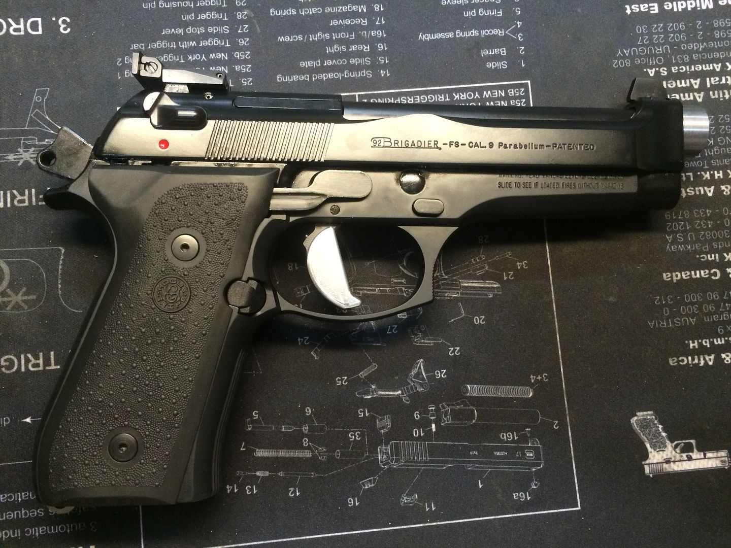

So here is the current Beretta 92 model offered by MCP. It is a brigadier (of which he is the only importer, he sells to Wilson Combat who resells them), so has the heavy slide. The quality of machining on the new Berettas is night and day to the old 92. The slide and frame fit is so good from the factory (they are machined in Turkey now) that Dr. Nick deemed rails to be unnecessary.
The MCP upgrades include a new barrel, pins inserted into the frame to guide barrel lockup, and trigger assembly. The trigger has been moved forward to correct length of pull, and includes a shoe for slow fire. Placing the trigger finger on the bottom of the shoe by the lip results in a 3lb pull, weighing in the center will lift 4lbs. For sustained fire, the shoe is removed and curved trigger is used. Pull is an excellent medium roll.
The slow twist KKM barrel is no longer used, MCP pistols now have a walther 1:18.5 barrel machined from a blank and melonited with a cmp-legal bushing installed.
Sights are standard champion or LPA-rear, with a cylinder and slide dovetailed front. Rear sight is slightly canted to the right, this is something I have seen on several match Beretta's and I believe is due to the way the dovetail is angled on LPA and champion sights.
The pistol is excellent, the trigger in particular is one of the best I have felt. The pins guide lockup in such a way that the barrel does not touch the frame anywhere but the pins, and slide opens and closes smoothly with no resistance.
The gun also comes with a sprinco system (if you aren't familiar it is just a dual recoil spring system like the ones used in most modern semi-autos).
As far as reports of terrible customer service, my personal experience was excellent. Great communication, good conversation and an excellent product delivered as promised. I was not charged until the gun shipped. I will be purchasing more firearms from Dr. Nick. As long as you understand that Mountain Competition is his hobby, and aren't in a huge hurry to make some deadline, I think you will have a pleasant experience.
I will report on accuracy when I get some 9mm cooked up - my end of season reloading chores are in progress. As of yet I have only shot it with some mixed reloads I had laying around and the results were very favorable.

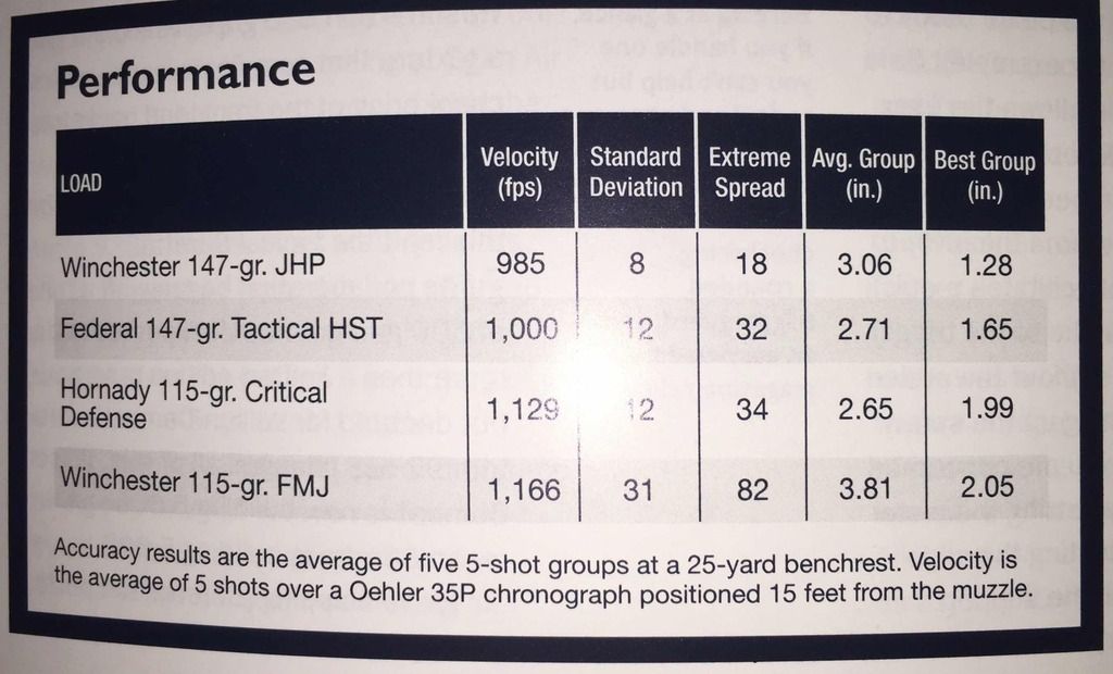

Wilson Beretta Accuracy
Stock Beretta M9A3 Accuracy
